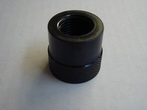

The gear is more-or-less 1/2" pipe thread. I used a 1/2" black iron female x female coupler with a piece of pipe threaded on one end and a nut tack welded on the other. I didn't measure the length of the pipe....maybe 2" including threads? It just needs to be longer than the pto end of the crank when threaded into the coupler. I think it is a 1/2" or 9/16" bolt...doesn't really matter, that pushes on the crank as the coupler pulls the worm gear. puller.jpg

The worm gear fits in 1/2" npt ...not 3/4
My vid proves it.
That is a very nice puller though. I may have to make one

I bought one of those worm gear removers from ebay.I didnt know at the time there was another piece that went with it,so I just blocked the piston with a rope,then screwed the pipe looking .thingy over the worm gear until it stopped against the case,then I grabbed a pair of channel locks and turned the pipe a little more and a little more until the worm gear came off,And I did 3 more worm gears the same way.4 husqvarna 51 s with no damage to the case on any of the saws.Not the right way,but it worked for me.
