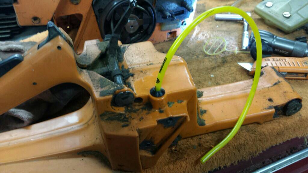

OK. The inside diameter of the Echo Fuel line looked much larger than the inside of the Husqvarna squiggly fuel line.
3mm ID and works perfect. Also makes good impulse line on other chain saw makes with the 6mm OD and the 5MM OD can be used too.
Here it is being used for impulse before cutting down.

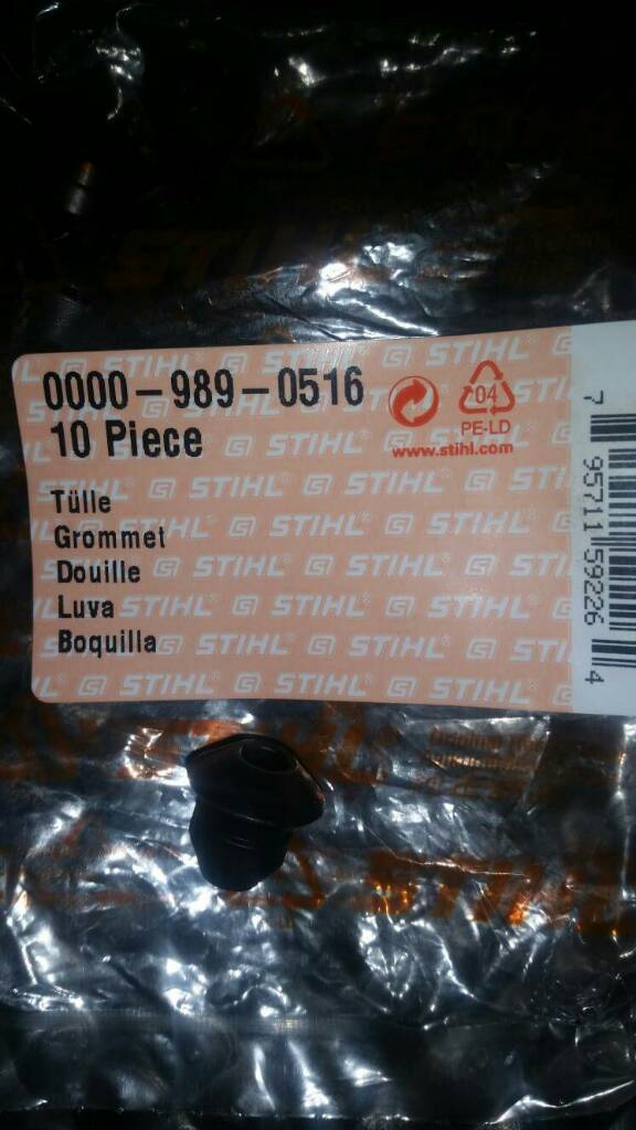

If your working on your own saws or with owners permission. Remember all it takes is a drill bit to open that plastic hole up. ;)
Learned this from the poulan board on my site by guys opening that tiny hole so all 3 lines are the same size.
I think @griffonks talked about drilling and using a grommet but don't remember the particulars.
