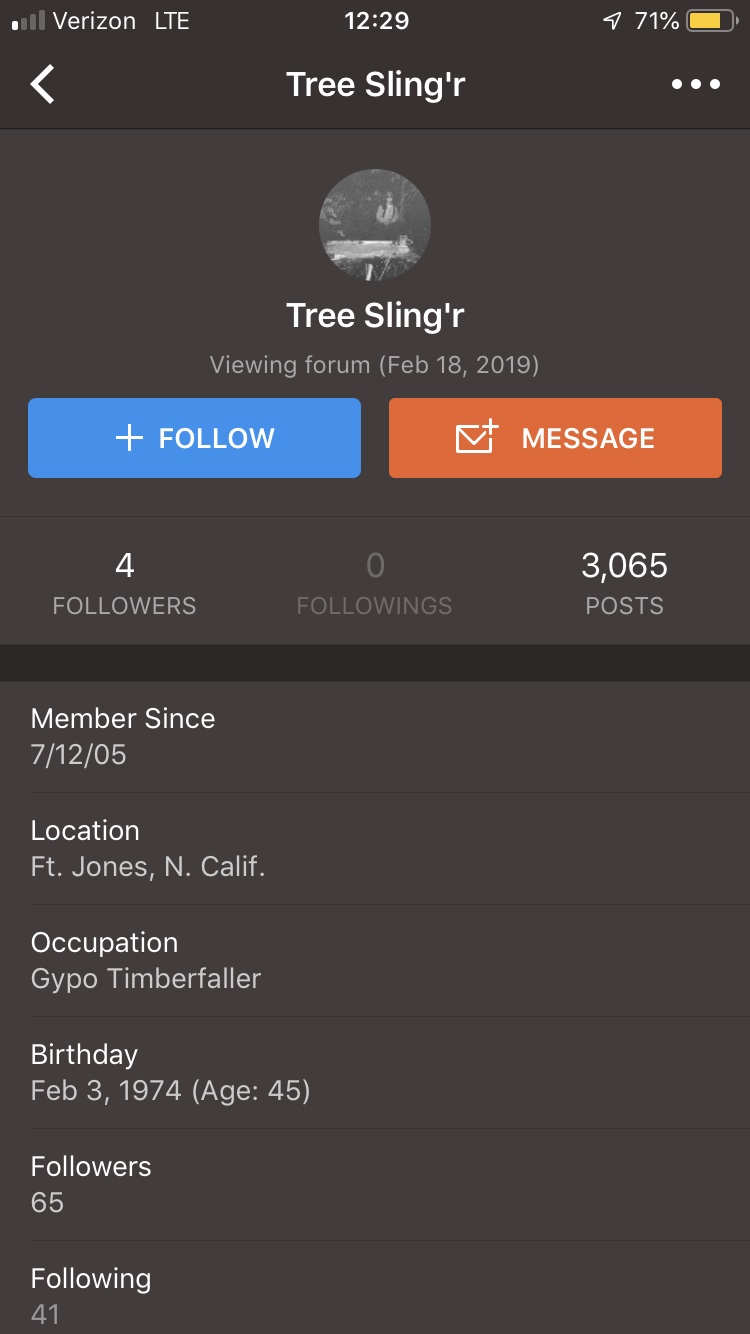

Bringing this to the top, while we all love our chisel and square, sometimes semi is what’s needed to get the job done. I’ve been cutting a lot of tops left by loggers for firewood and it’s a mess full of red clay and rocks.
I think I remember this guy posting a lot of info back in the day. Might have to venture back over there and see if I can find it.
I wish jasha was over here.
@tree sling’r
Edit:
This guy-
