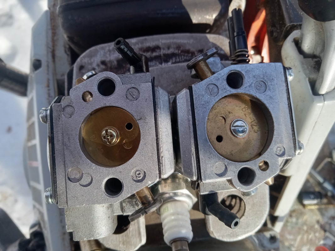

My 1983 CS-8000P. Just got my hands on a 1980 500VL.
Nice old saw. The older 8000p had a substantially larger carburetor than the later models. Feeds the saw better after port work.
