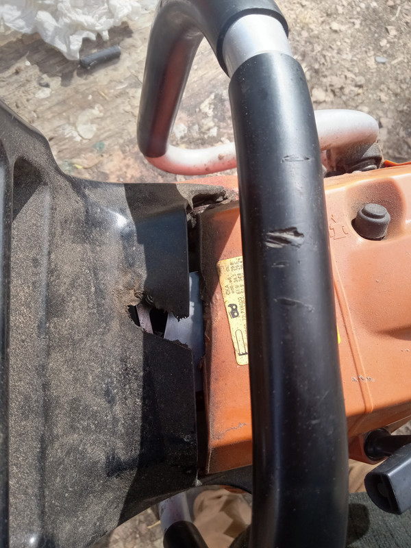

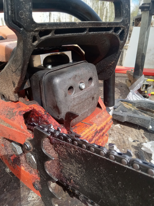

Good job echo, they built a deflector out of the thinnest sheet metal possible. Rather than welding the deflector in place, use a handful of tiny screws to hold this sht together. Presto: deflector cracks and everything rattles off. Blow a nice hole right through the brake handle and melt the top cover. Heated handles nice n toasty, melt the gloves off your fingers.
Anyhow, traverse creek sells a nice thick aluminum replacement. I used loctite 680 on all the deflector screws, and the base of the deflector. Little pricey, but definitely an upgrade from that tinfoil garbage it replaced.

Ouch! She got real toasty. After some solid run time the short comings arise. Haven't used my 590 enough to break it yet....except the time I launched it from the skid steer bucket into a stump😂...forgot it was there.
That's a nice looking replacement deflector. Let us know how it holds up.

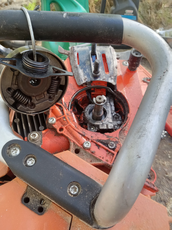

Coupla hard years on the 620pw, was time to spin off that clutch and clean out the gunk. Grease that clutch bearing and replace that worn out rim sprocket.
Holy sht! A STEEL oiler gear.
Non of that plastic garbage that always strips out. What a brick-sht house of a saw. Love the filthy-good, indestructible METAL oiler gears on some of these echos.
Man, some of those metal gears are HARD to get off a crank after years of abuse! Lol
Some wear a Grove in the crank after years & years.
Vintage Poulans come to mind.
I had to heat one with heat gun recently because all the gunk had turned to glue.
That may be why some of the plastic ones work well enough until needing replaced.
$5 "consumable".
Metal ones are harder to find nowadays than plastic ones.
The 620's have a metal drive gear and a plastic oiler shaft driven gear, so the oilers themselves are the ones more likely to strip. Thankfully you can buy them straight from Zama, the original manufacturer of the oiler. The metal drive gear does not ride directly on the crankshaft--it has a plastic sleeve between it that is connected to the spanner that is fits into the cutouts in the clutch.
Cool.
The old Poulan's have a metal drive gear mounted directly on the crank to turn a plastic drive gear in the oil pump.

Yep, It's a smart design on the 620 oiler gear:
2 piece. The worm gear is metal, the little gear inside the oiler is also metal. But the plastic sleeve acts as a fuse.

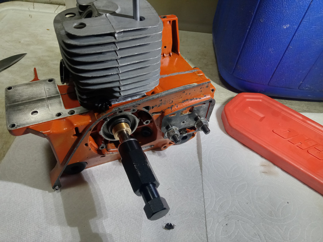

Nother good one if u have the echo oiler gear removal tool and the installation tool is the metal worm gears on the later 6700/670. The install/removal tools work on the cs 530 and many others too. Just completely overhauled a brick sht-house cs 530 few days ago. And a 6700 couple months ago. Also replaced a melted plastic oiler gear on a cs 4910. Anyhow, here's that pressfit goodness on the 6700:

I think Husqvarna makes a tool like that for their saws.
From what I've read, they are pretty much universal with some persuasion.
My redneck rebuilds, its just a heat gun & screwdriver! LOL
