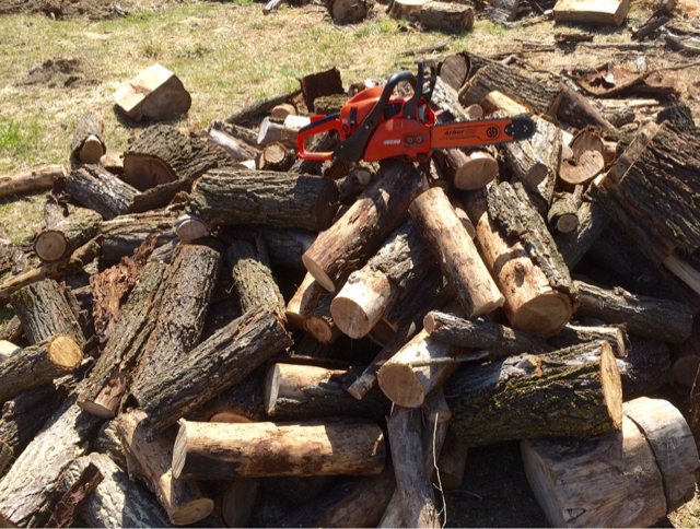

My latest Echo project. I read on a posting that Left Coast had these bars on sale. So I put this 12" on one of my 310's. 46DL Oregon lo pro and it cuts and handles great. The 310 ran rings around the MS170 I had before and with this setup it wouldn't even be close.

It cut this pile of limb wood on less than a tank of premix.

Nice looking little saw. Bet it is fun to run!

It is now! I am going to put this bar on a CS- 352 and try that out too. All three small Echos have lost their cat and limiters are trimmed, making them a whole new saw.
I run TruFuel 40-1 in my small Echos. They will run a quite a while on a single tank of fuel.
On a side note, I noticed right away that this bar does not wave back and forth by the tip when you get to cutting decent wood. I think the rigidity keeps the chain in the kerf better and you are not recutting with the top of the bar on the way down through the wood. This would have to create more drag on the chain, and at 30cc these little saws need all the help they can get.
