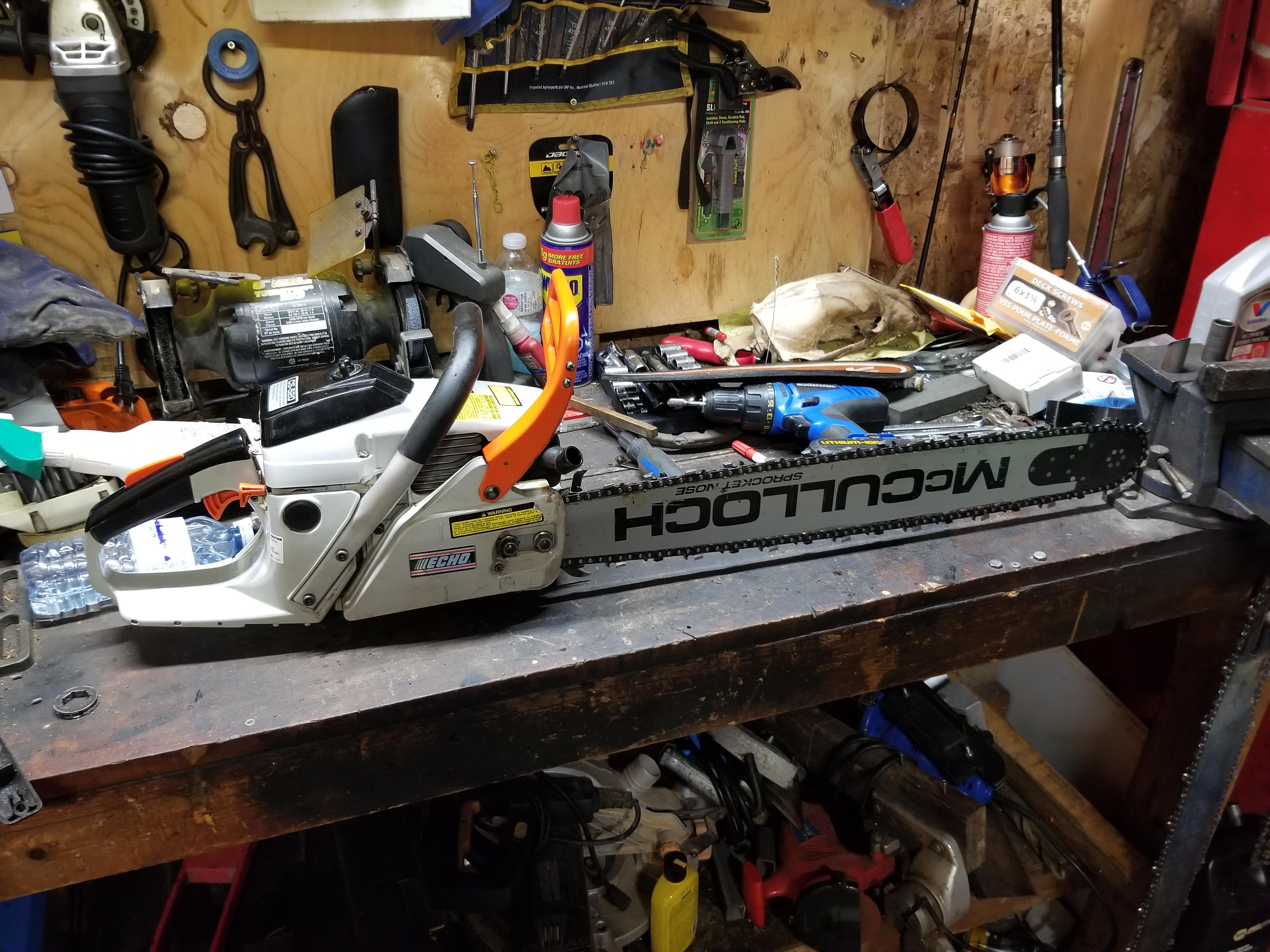

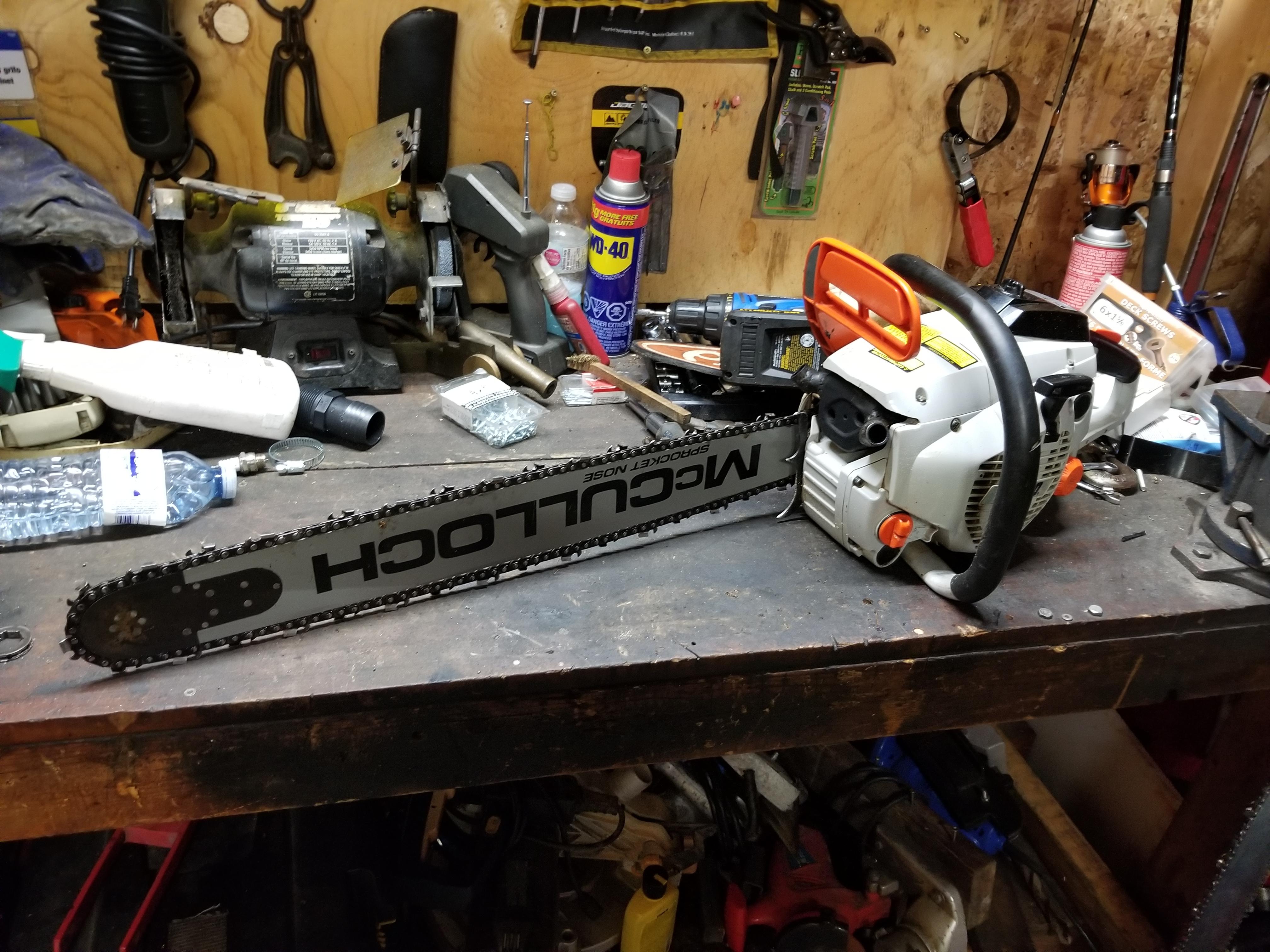

Thought i would try a 24 inch bar on my 520. Made a few cookies on about a 16 inch nlock of wood. Seems to work pretty good. Little bose heavy now which i expected.
I did this with no intentions of burying the bar. Just for the extra reach.
