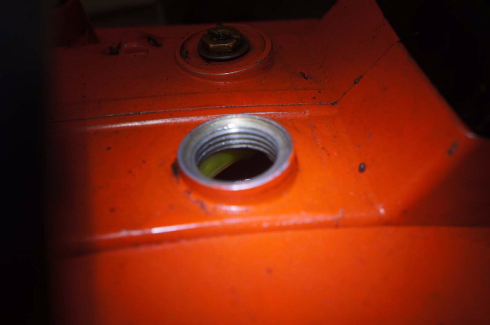

John Deere 30/Echo 302?
Where does one access the oil pump pick up line? Is there some secret handshake?
I’m getting no output from the pump. Have run the pump up and down it’s entire adjustment range and get zip. [emoji90]

Those are tough to get at through the filler cap opening. It has been a few years since I did mine. The barb in the tank is large, so I think I used a larger piece of Tygon on it and transitioned to a smaller piece. Stuffed it all back into the tank. It is a real pain to get line fit onto it. Curved pliers/forceps, patience and a couple cusses. Here is a pic. You can see the Tygon, but the fitting is only visible if you look up and back toward the 1-2 o'clock position. The fitting is awkwardly located toward the top of the tank and on the PTO side. Good luck.

[emoji90]
The pickup line on mine is obviously gone. [emoji2959]
And, my curved surgeon clamps broke some time ago. [emoji90][emoji2959][emoji3517]

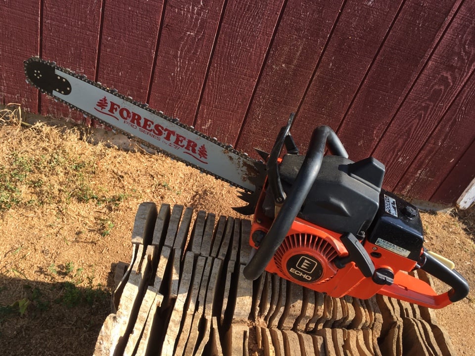

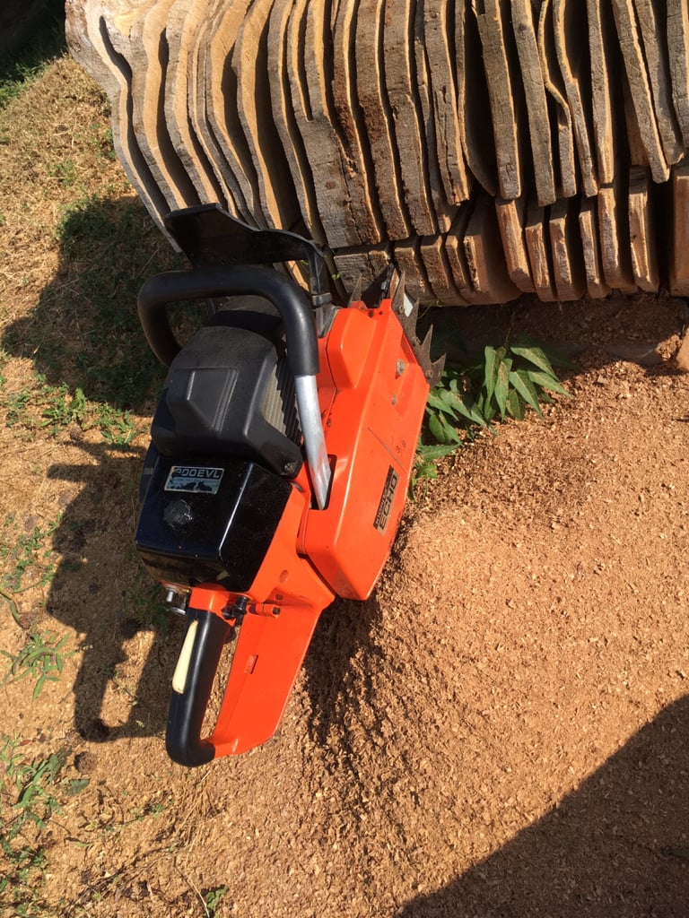

When are we gonna get to see this “cool thing” you tease us with?
Here ya go, thanks to Robin Wood for his help getting it into the USA. Got here today and took 10 days to arrive. Right now I have no plans to gas it up.
