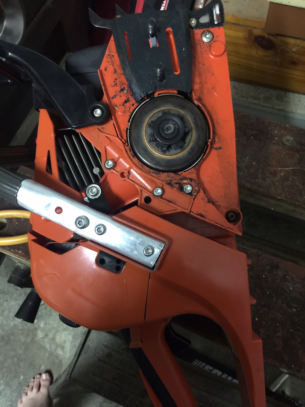

Around a year and a half. Only thing I’ve done is take the limiters and tune it a little fat. I’ll do more after the warrant runs out. Oh I forgot I did get a Chinese 372 half wrap and bend it and cut it to fit the 590. $6 for a metal wrap lol.

Honestly haven’t taken it off to look. May do that before I do a lot of cutting this winter. I hear they can get really loud with a muffler mod so I’ll research that more before I do one cause I don’t mind loud but I don’t want war splitting loud lol.

Sounds like your okay with the handle mod and price was good. Was that troublesome with the bend and cut or not to bad?

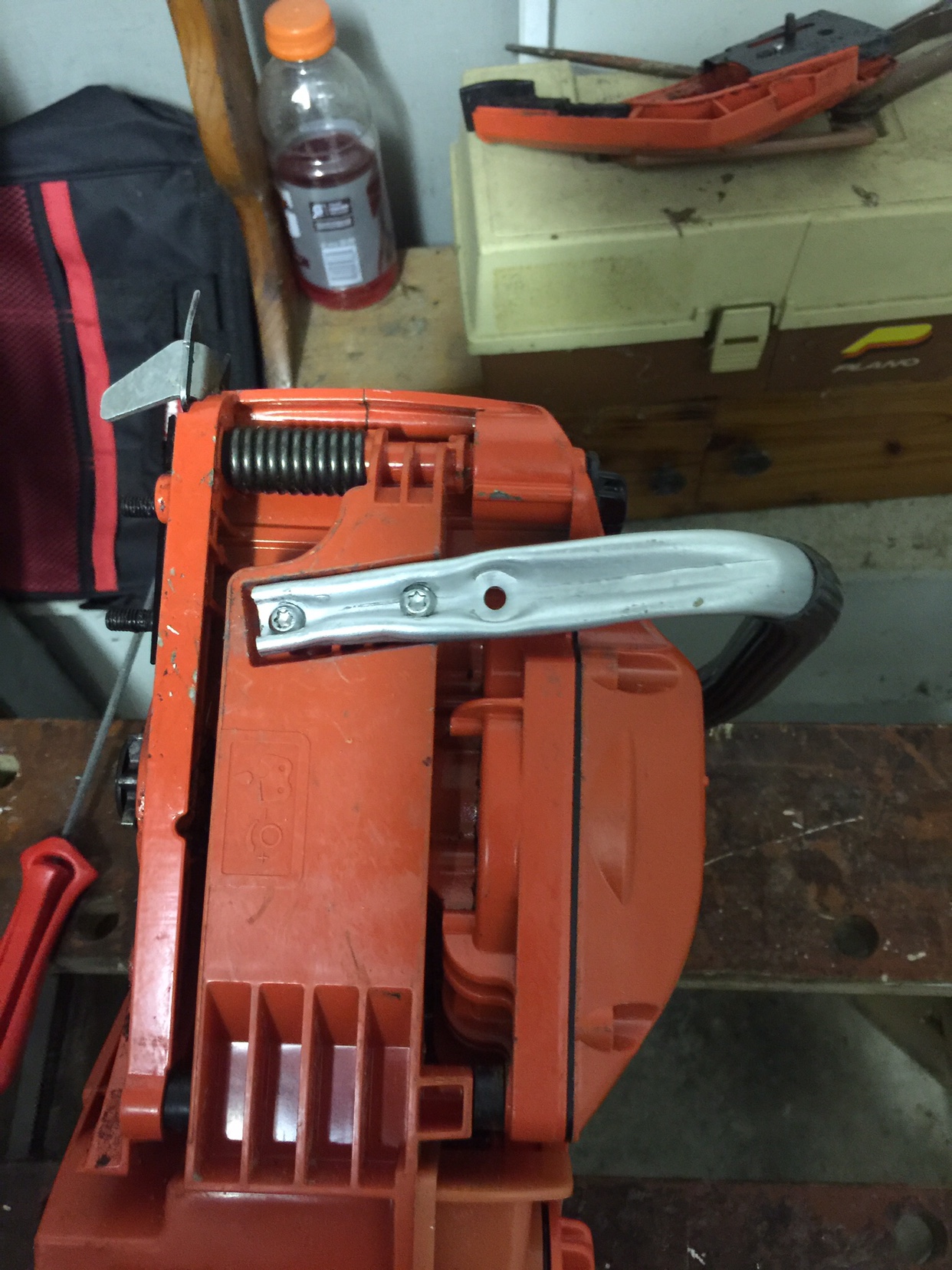

It wasn’t too bad. Took about an hour to get the piece cut just right and bent close. I just wanted it to be solid and didn’t want to pay $60+ for the real echo one.
Haven’t had any big wood to really use it but vibes felt fine yesterday with the little cuts I was doing and it felt plenty stout. I didn’t buy one of the buy it now ones from Hutzl I just got the bid one for $6 and no one else bid lol.

Good deal and looks nice. I was curious to see a picture and you covered that.
Its not the prettiest install lol still need to do a little trimming but I was working on it during the middle of summer in Alabama with no ac in my garage so I’ll clean it up some this winter. It’s holding fine now though.

Thanks for the extra pictures. I could live with that modification. Gets me to thinking on some of the other Echo models and modification of the plastic to aluminum on them. Guess it was hot, noticed you didn't have any shoes on either in the garage.
