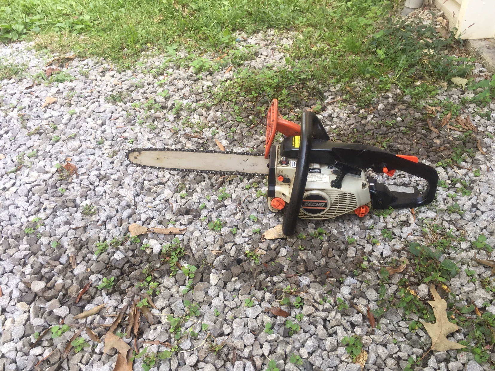

Got all the parts I need for my little echo. New plug, air filter housing and filter, new primer pump, a couple fuel lines and fuel filter and she’s good to go. Ran great once tuned and ran a tank through her today. Buckled up little trees just fine until some how it grabbed a chunk of grass and sucked it into the clutch area instantly dulling the chain cause of the dirt clod. Oh well not even tired at all lol so money well spent
Edit : oh and a new pull cord too. Got the pull cord for a dollar from my echo dealer lol. All in all I got $65 total in it so not complaining at all.

Very good! When it's time for a new chain I recommend Oregon PXL. My small saws do great with it.
