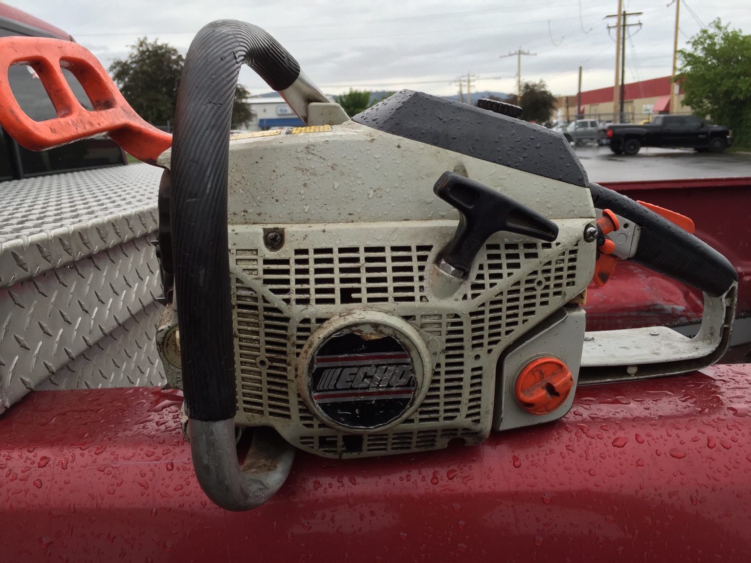

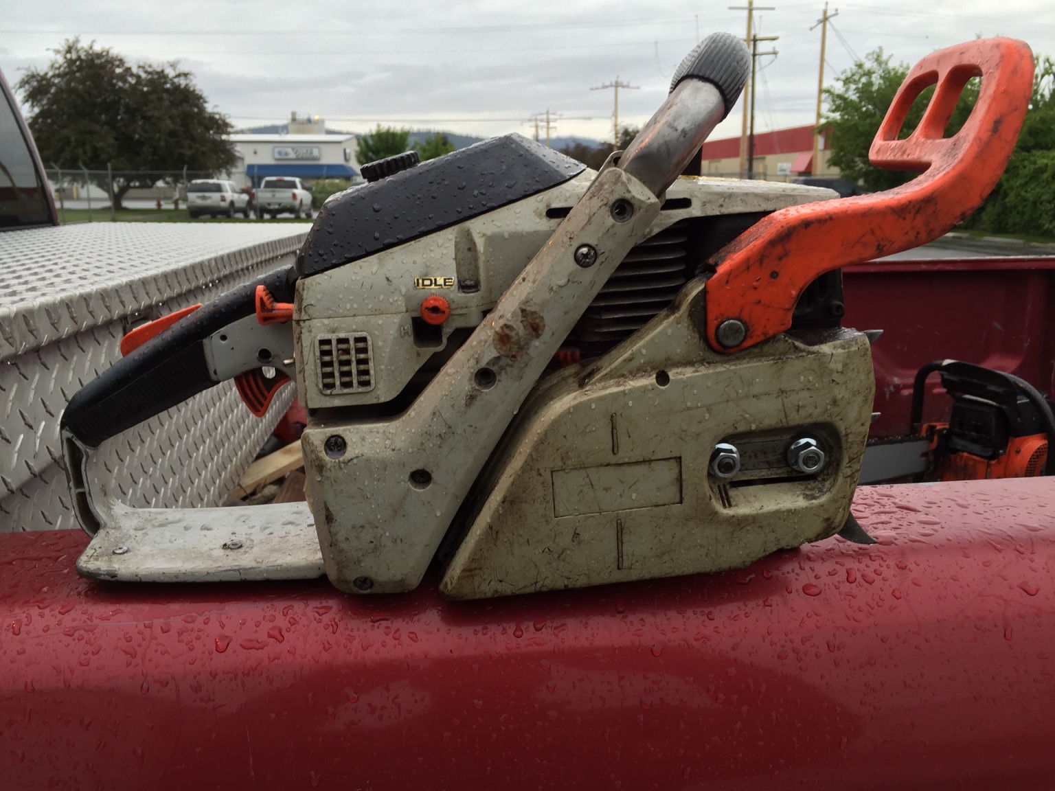

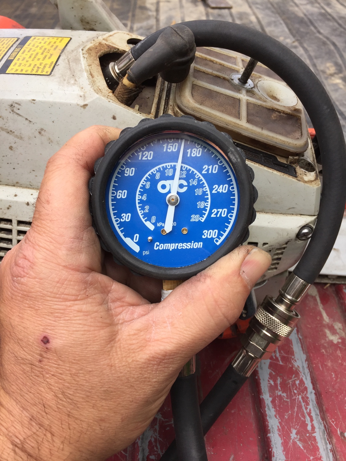

Grabbed this poor ugly 6700 up today cheap. Guy claims its scored, but pulls over like tons of compression.
I'll pull the muffler later
