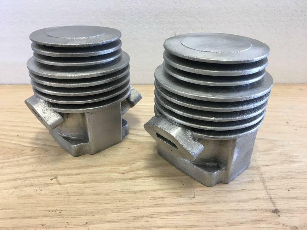

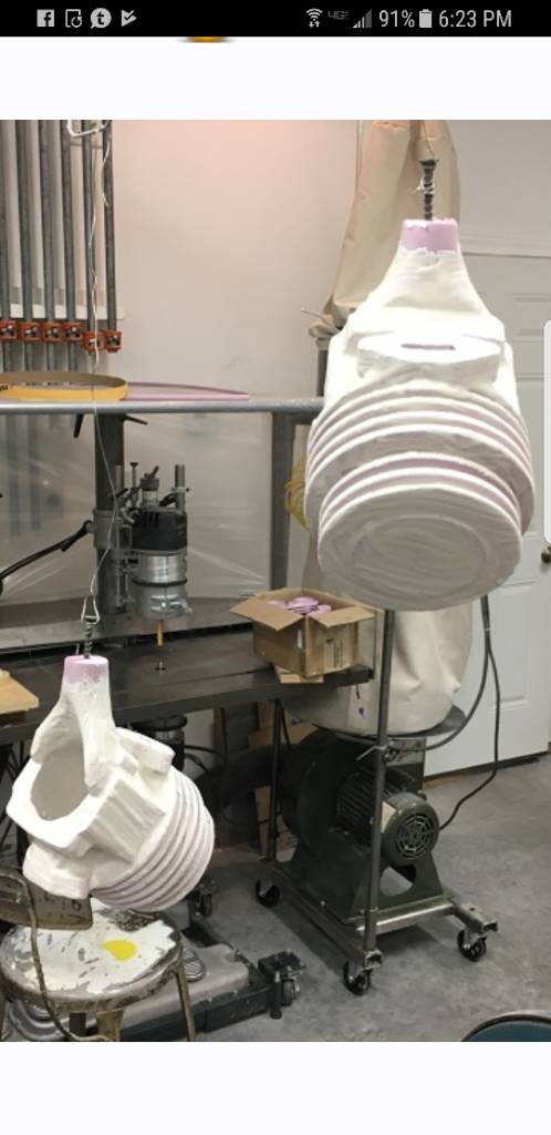

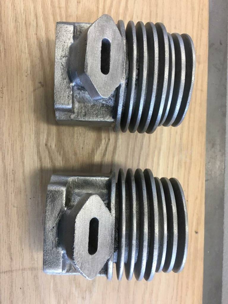

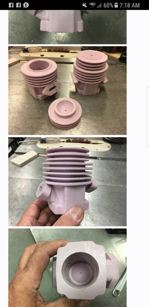

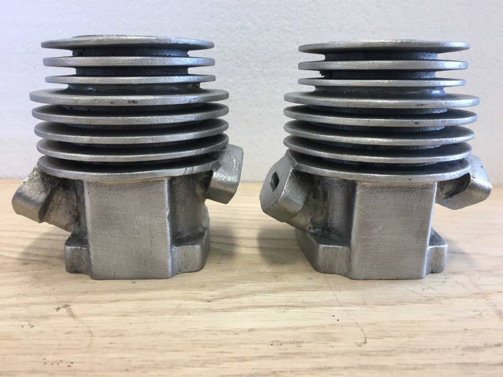

Amazing castings! Who did this casting for you?
A fella I found on a metal casting forum.
Was looking into casting them myself realized I wasn't going to have time, so I farmed them out.
He uses lost foam technique.
He made something really similar to see if it could be done. Asked if he wanted to attempt a useable piece.

Well they come out pretty good imo..
He sending me one to check out.
Have to see how it cleans up. Once it get home and have time to machine it.

Looks like he did a great job. But every time
I see the castings they remind me of Squidward's house.
Red97
9:31 PM
385
Jan 2, 2016
7,497
54,168
MI
Lol, it does somewhat....
Hoping to have some time next week when I get home to true the base, add the holes, rough the bore and add the plug hole
I'll set it for 52mm, lay out/rough in the ports at the correct height. Final bore to press in the sleeve.
Have to see if I have room for transfer covers, make it a lot nicer to shape the transfer ports. Not sure how much real estate I have for hold down bolts.

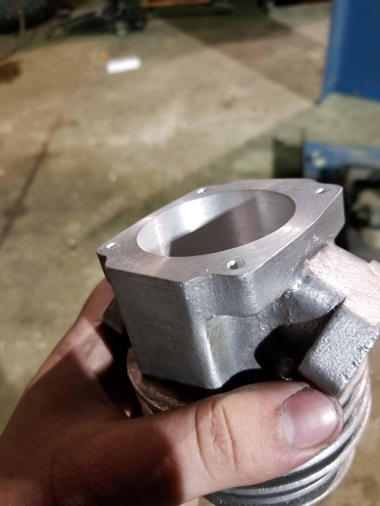

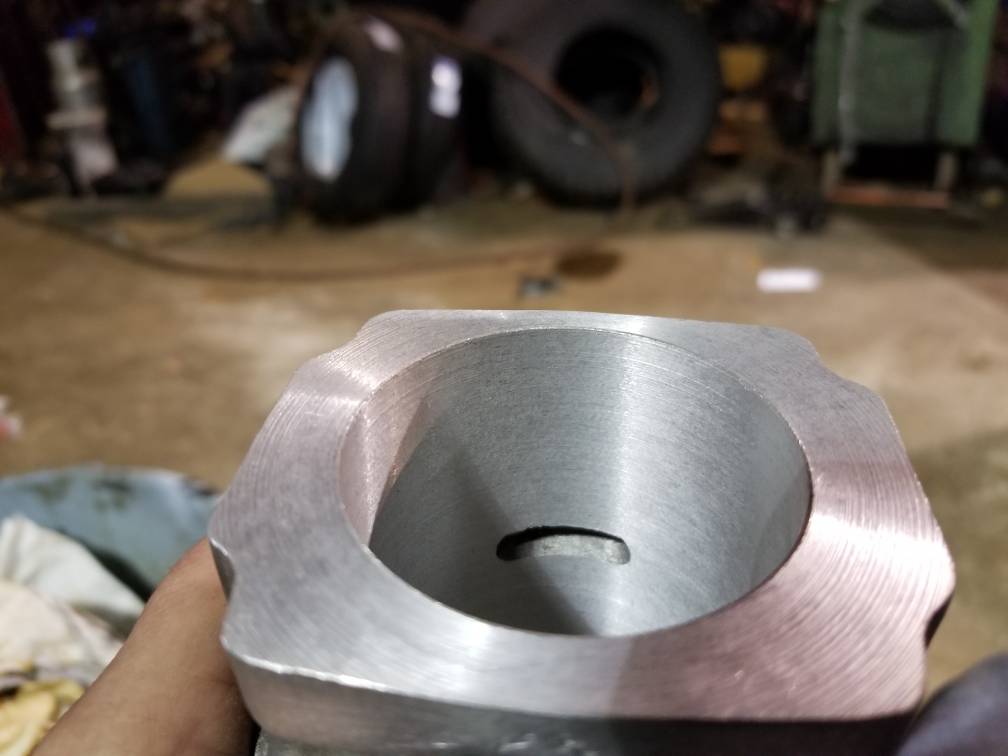

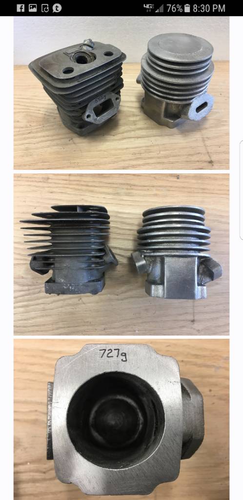

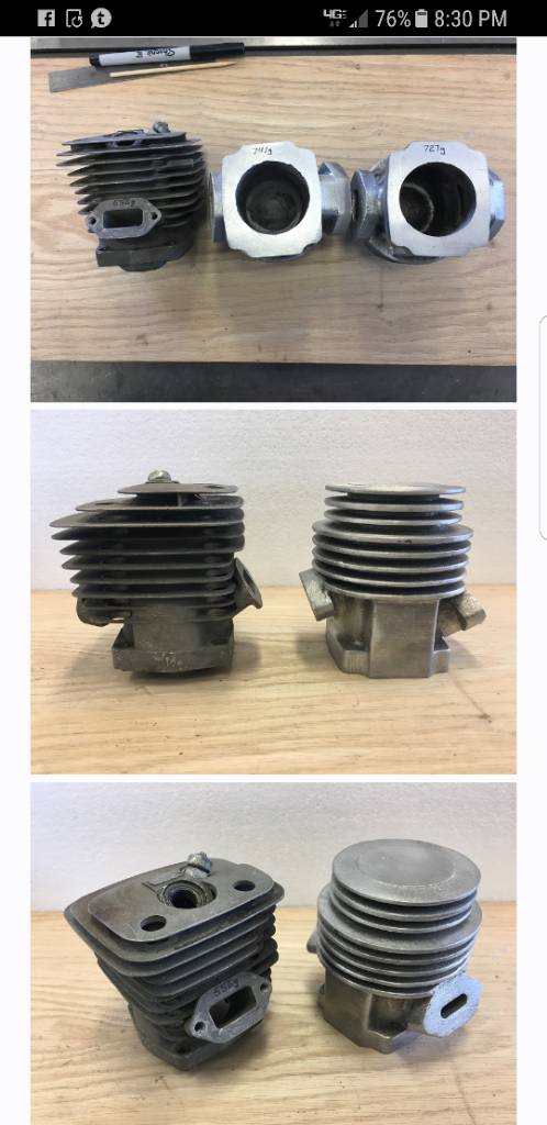

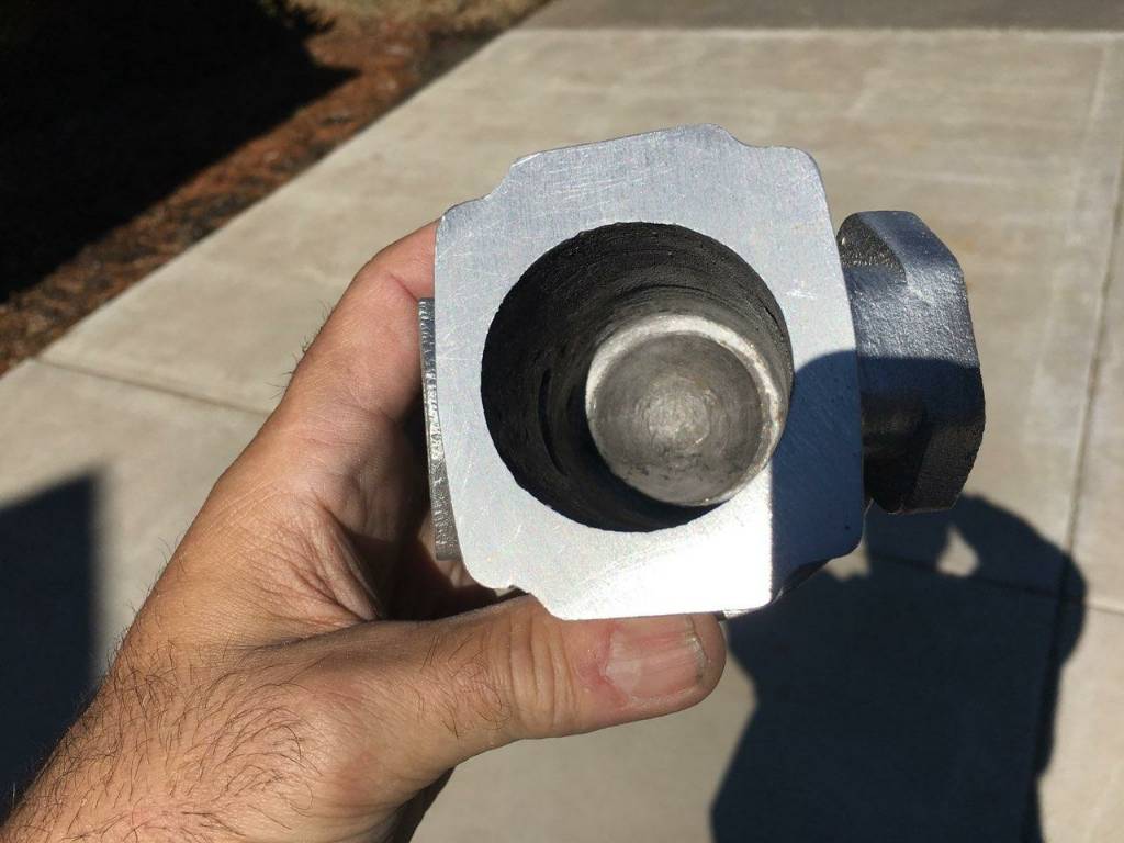

Just roughing it in.
Bore at 52mm base perpidicular to the bore.
Looks like it has some core shift. But should be ok.
Still have to get it bolted down to the case, see if the height needs to be trimmed.
And how much needs to come out of the band.
