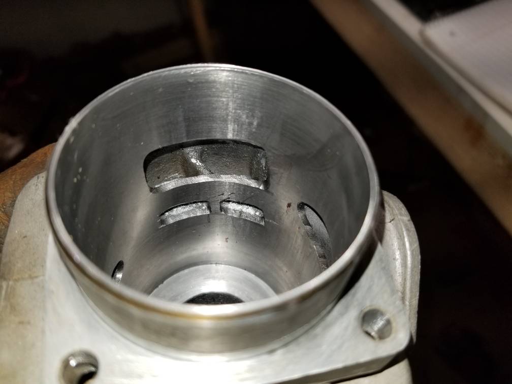

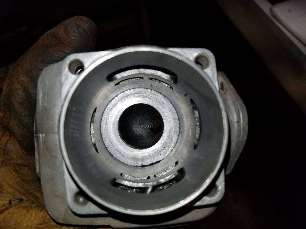

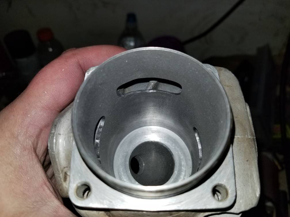

Couple ports roughed in.
Gonna run a 272xp piston.

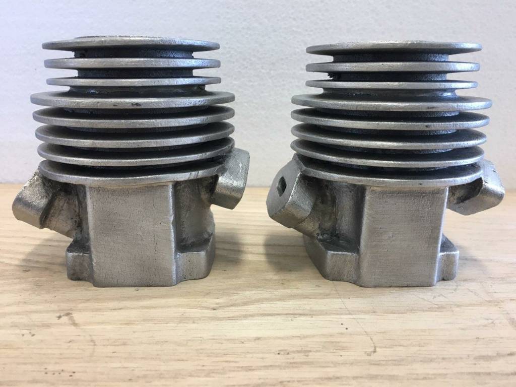

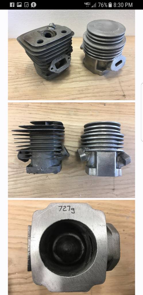

This saw shouldn't be much if any more than 14lbs pho.
Might be oing on the 620 chassis.
I do have another 600 here as well, I will have to check and see if it has the larger 6202 bearings 38mm od vs the std 35mm
It it does it may be better for the extra displacement.
