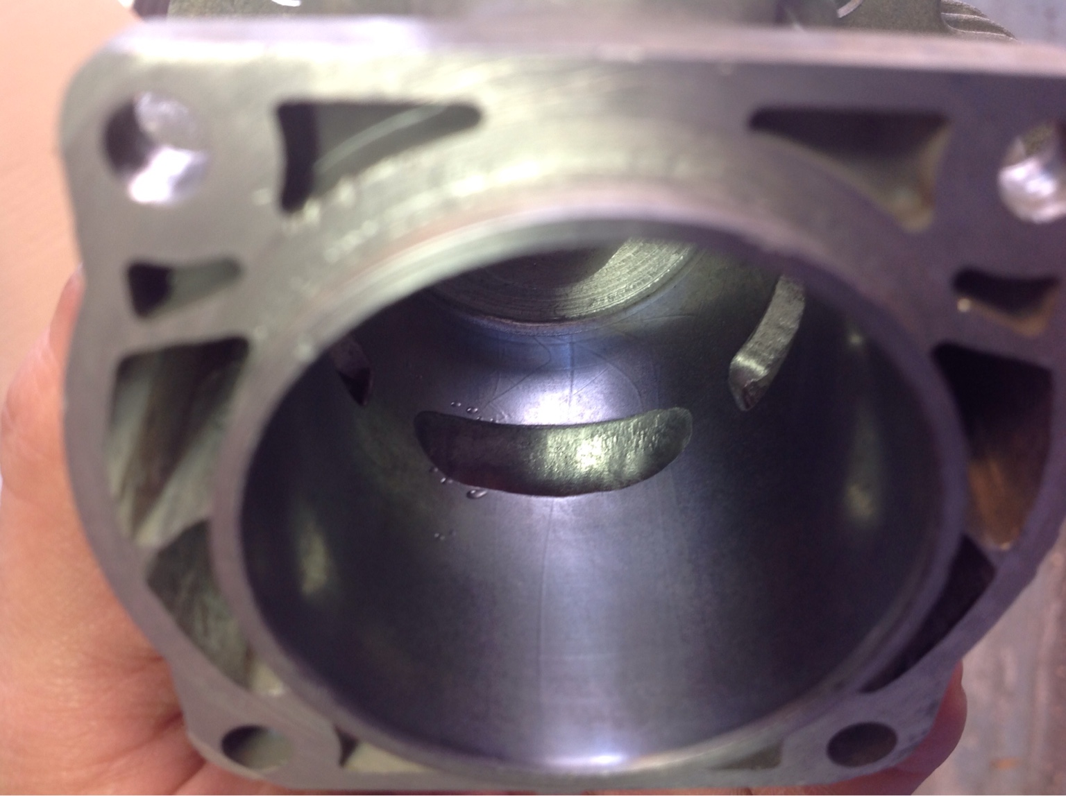

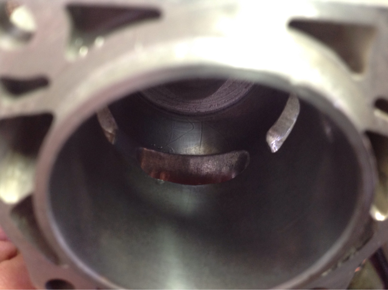

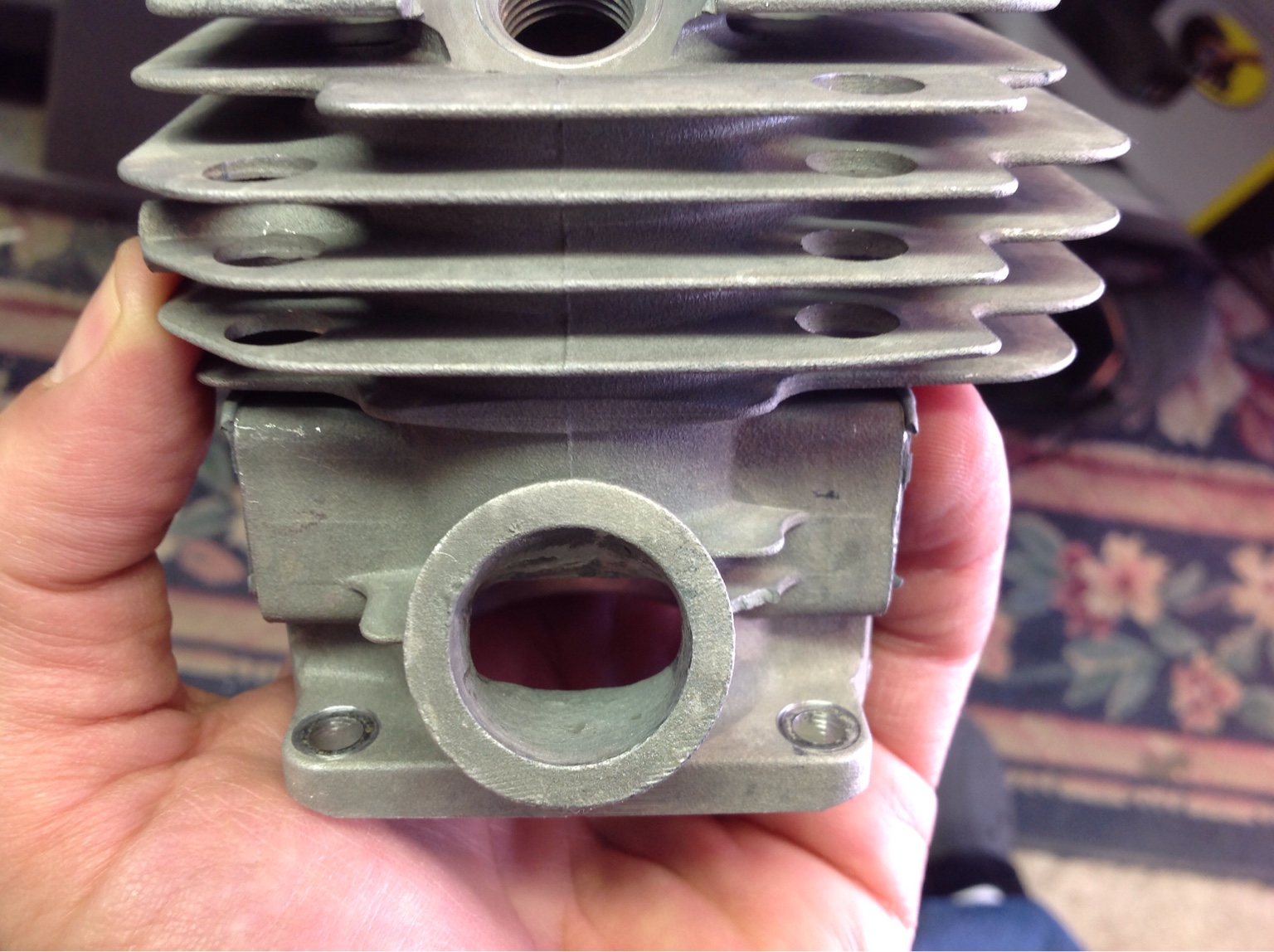

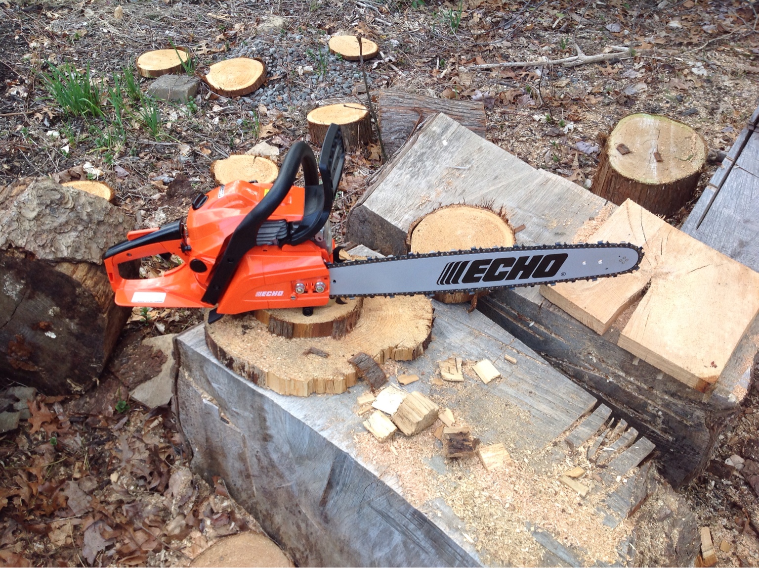

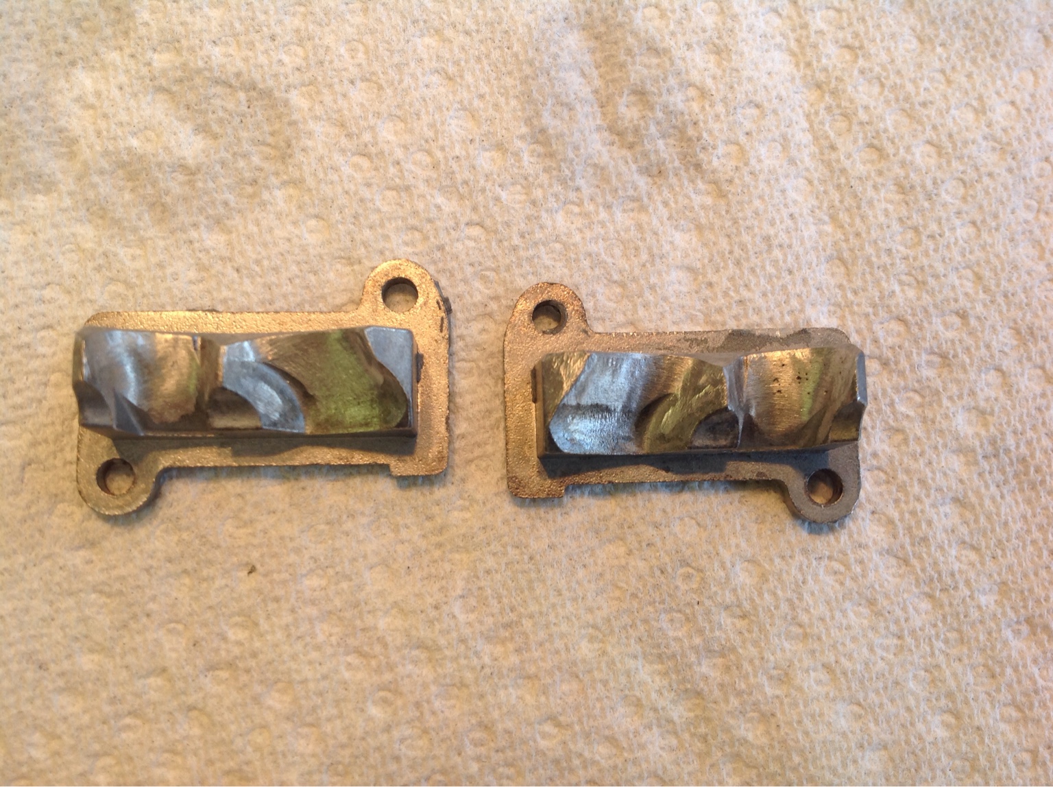

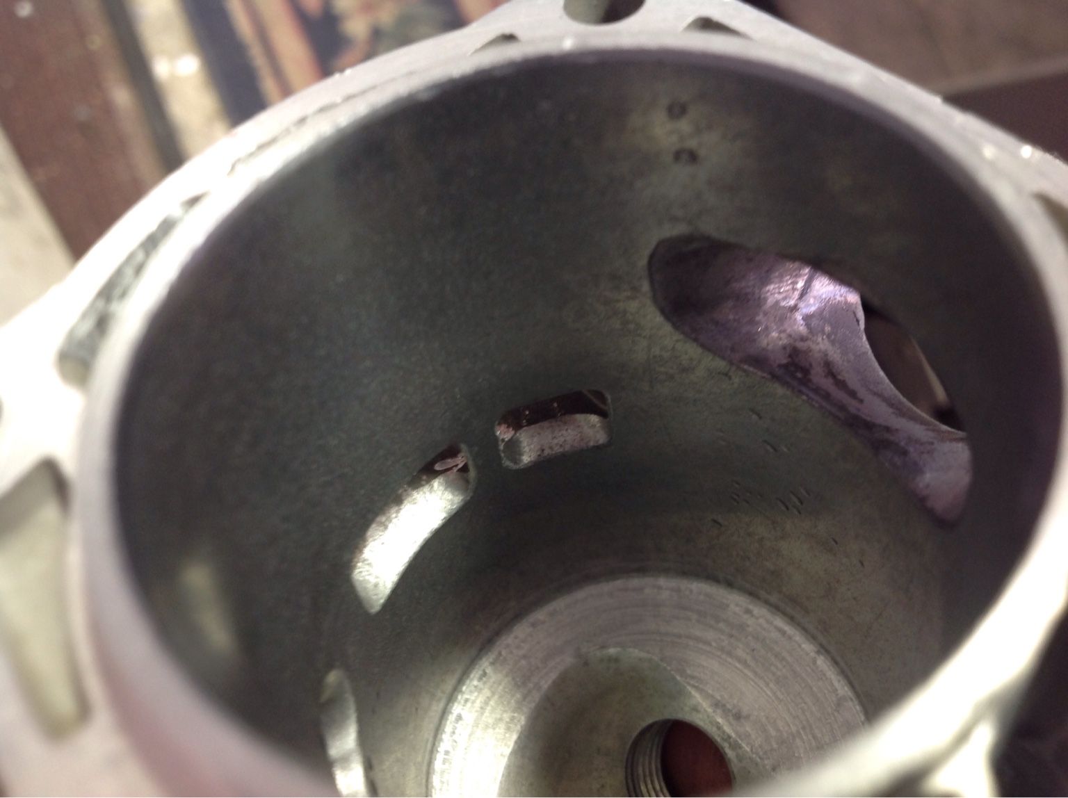

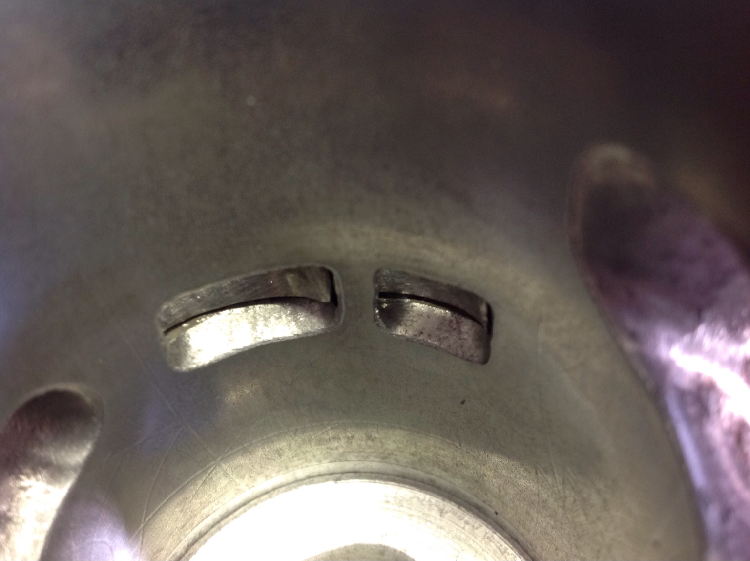

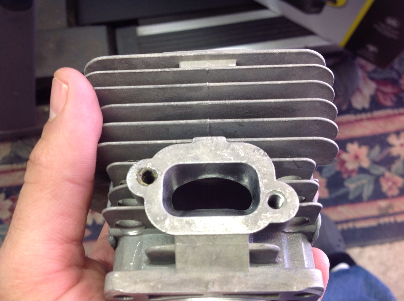

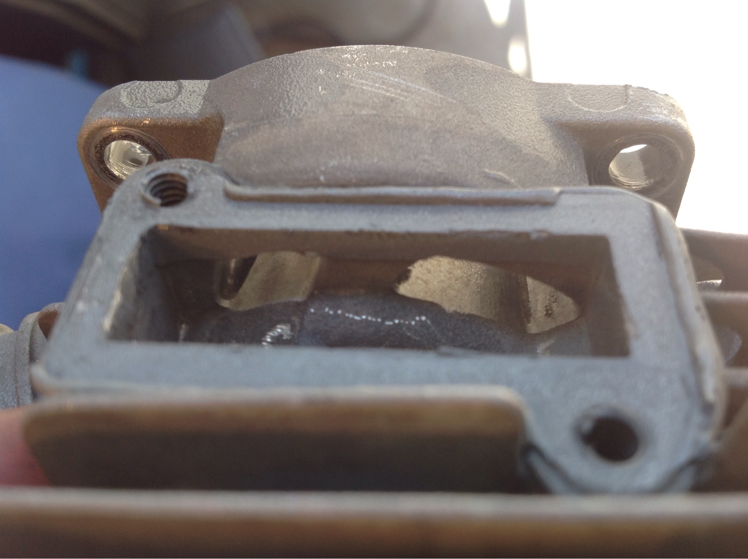

My saw done. Really fat in the video.
I opened my tunnels, you'll see in the pics.
My final numbers were 106.5 Ex, 121 main upper, 122 second upper, 82 intake.
This saw can pull a 20 no problem.
Even with the extra work, the saw only hits 13,500. Leaning the carb out does nothing. To the point where it has to be tuned in wood.

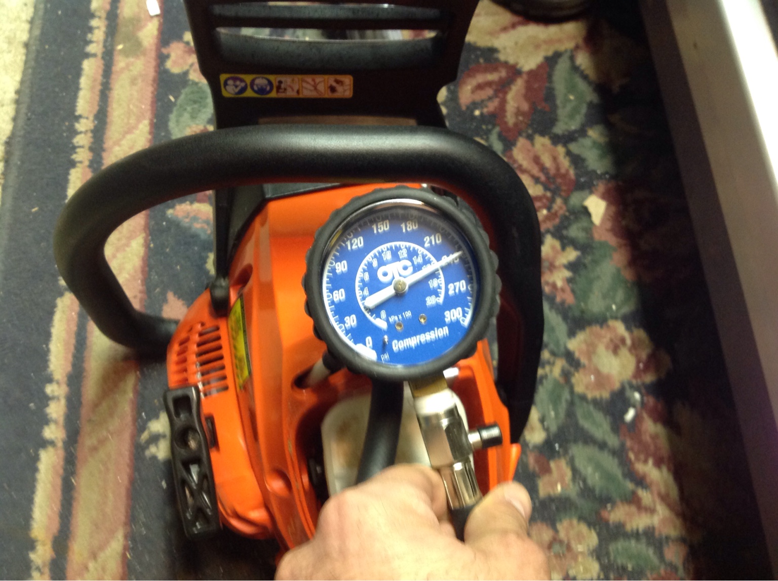

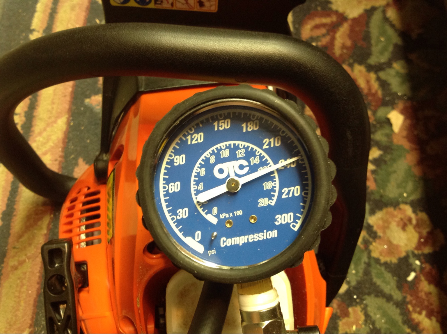

The recoil is a spring loaded type. Doesn't seem to like the comp. I haven't taken a reading yet.
Build quality much cheaper than a Stihl, but I REALLY like this saw.
Looks and sounds great.
Did you leave the bottom ring out?

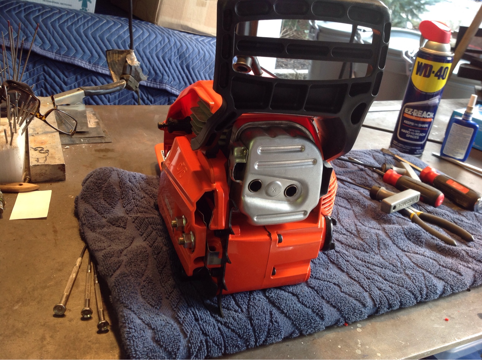

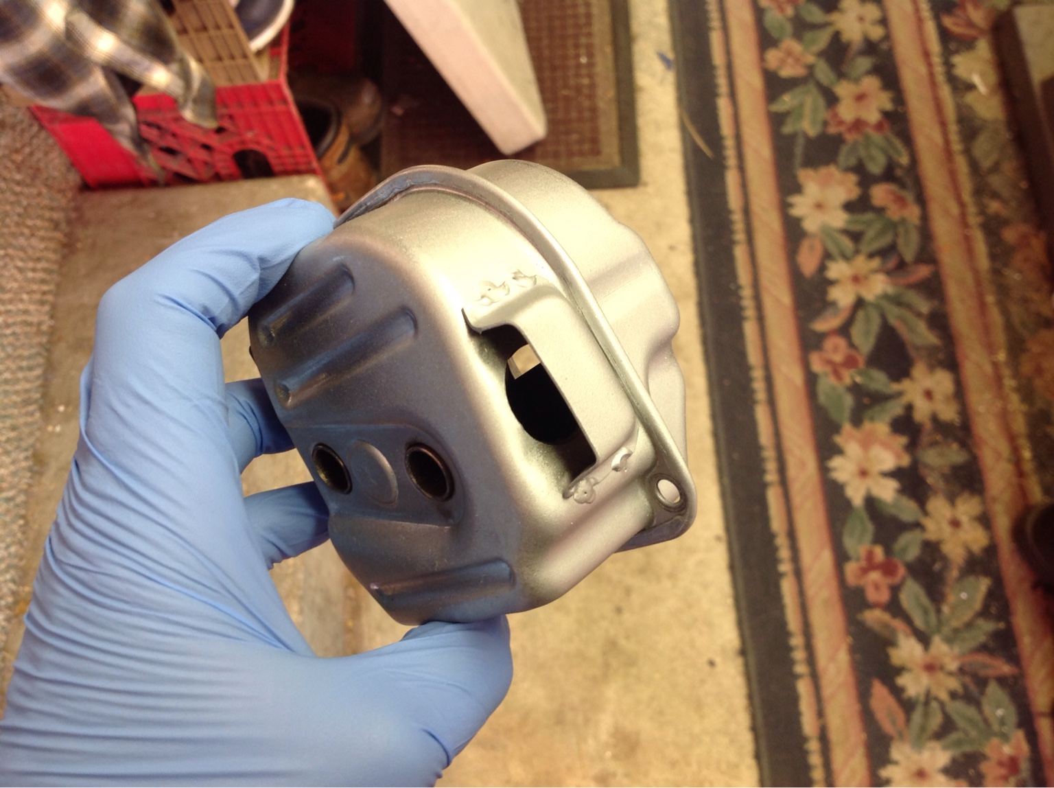

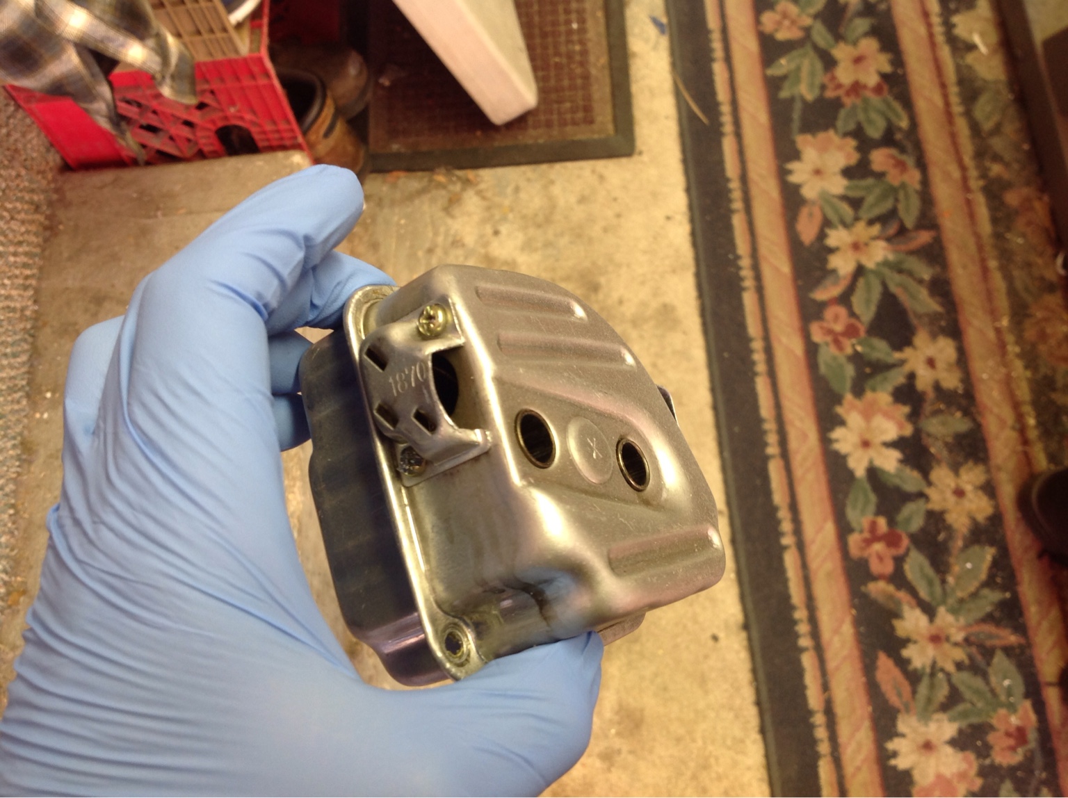

Nice muffler mod ;)
Definitely plan on opening my second port more, seems yours is easier to hear the 4 stroke.
Yours should really turn up if I can get these carbs figured out.

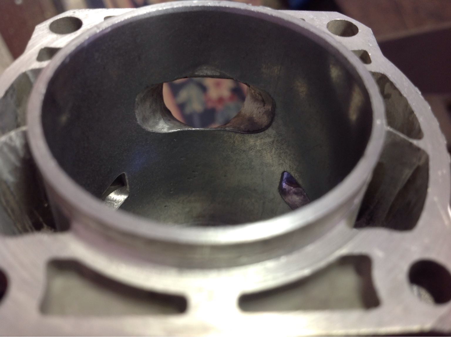

Thanks.
Single upper ring.
It could not be leaned out. Pulls hard.
I'm thinking that single ring is where the rpm is coming from.
I'm at 106 125 76/88 with the tunnels hogged in a similar fashion.
You have an 026 built you can compare to? Just for giggles.
I'd say we have a winner with this thread, 3 complete saw builds in one thread with minimal derails.
