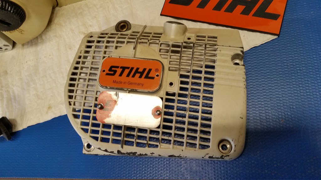

Also this happened..
NOS plastics from D-Dave and another ebay seller. I saw them and figured why not! After seeing the other 064 builds on here I wanted mine to kick a$$ too.
I also worked on the handle bar, stripped the rest of the paint off and straightened the rubber hose/trimmed the ends.
The Powder coat guy at work doesn't have a good match for the bar and recoil cover. Kinda bummed I cant fix them up for free.
