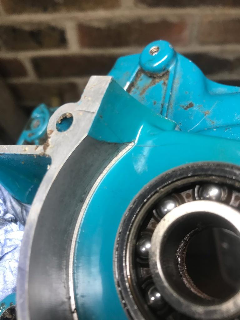

Wonder if anyone can ahead some light on this Makita 7900.
Colleague heard a nasty noise while pulling over his saw. Long story short I pulled the cylinder off to discover it had broken at the base! Luckily I had a spare lying about so tried to rebuild, but discovered the crankcase had cracked when I pressure/vac tested it. It appears that the force of the cylinder breaking had also cracked the case.
I ported the original cylinder, so conscious it could be something I did wrong, although never had this problem before. The build was base gasket delete and the lowers were case matched and blended, intake and exhaust were widened and smoothed, but no timing change (other than BGD). I torqued down the cylinder bolts with locktite to spec also.
Any ideas what has happened here? Could it be a casting flaw?

How were the old bearings when you pulled it apart? Maybe they gave out and allowed the piston to hit the band?
The bearings were perfect when I built it as only had 25 hours or so use from new. I’ll double check, but I don’t think it has more than 100 hours on now!
