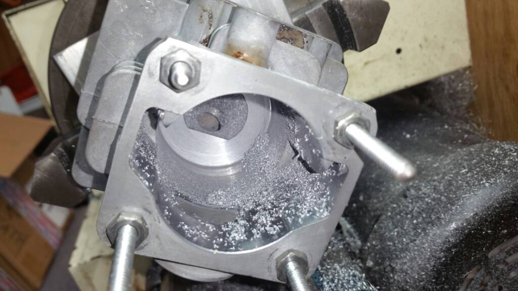

If you’re asking about an 026, you can scrape the factory band out on an angel to match the piston contour, then add varying grits of sandpaper to a piston dome to match it. Or you can cut the dome off the piston and machine the chamber flat.
Here’s a sanded band.

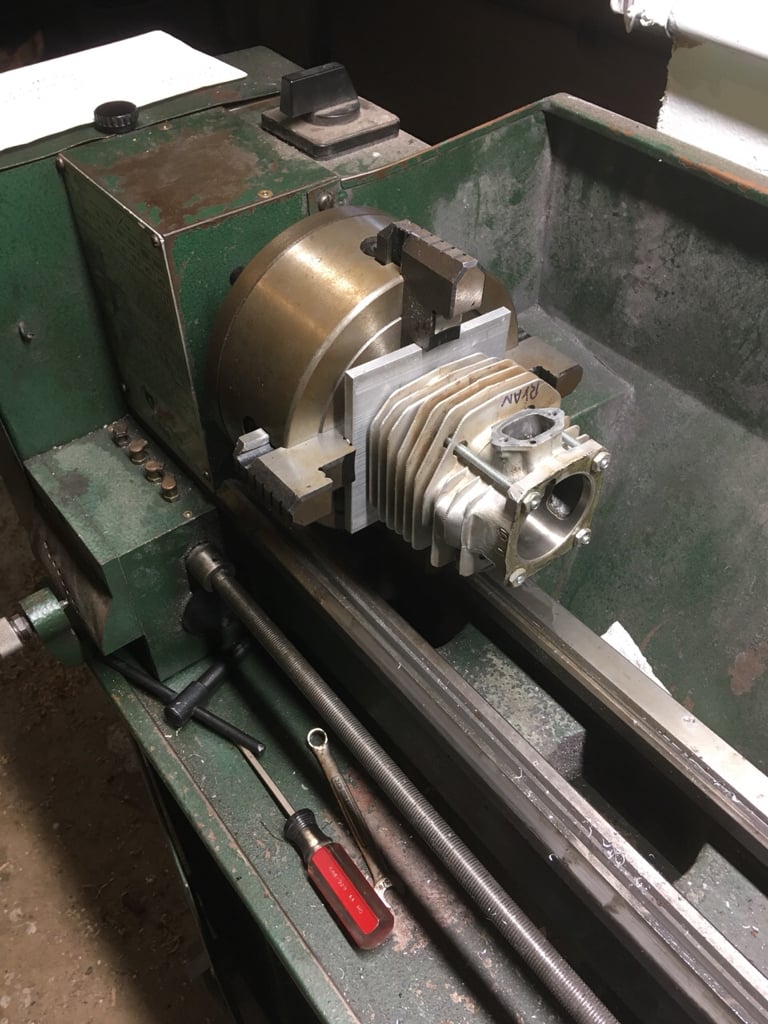

Would any one be able to snap a pic of their mandrel for cutting by hand? I’ve got a good idea of how to secure the HSS but would like to see if I’m on the right track. Thanks.
Got em at home. I use a allen set screw put in on the load side of the cutter, so the the force pushes the cutter back against the slot in the mandrel and not the set screw.
Just mill a 1/4" slot tilted back 3*

It's all theory and a bit of experimental tinkering .I've never cut the band but if I did I'd just use a boring bar .
