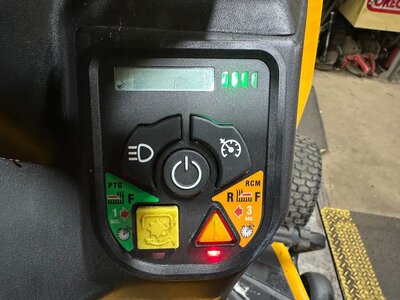

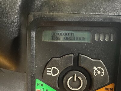

It is because of your work I am here. This is my issue the machine will not close the contacts when I hit power. I tested the battery with their break out cable and all is fine. When placed in diagnostic mode every switch changes except the brake. It remains "1" never a 0. So I thought that I found the issue. Well I tore the machine down to get to that switch and it is fine. According to the documentation it is the third character from the left.

The instruction are from Cub Cadet. Do you know how to put this machine into diagnostic mode? If not this is how you do it. Turn the key on. Hold down the following two buttons RCM and Power button in the middle. The screen switches to "Diagnostic Mode" let go. This is how you check the functionality of the switches. Each position means something "1" means on "0" means off. If they do not change when you change thing. This might provide some direction.
