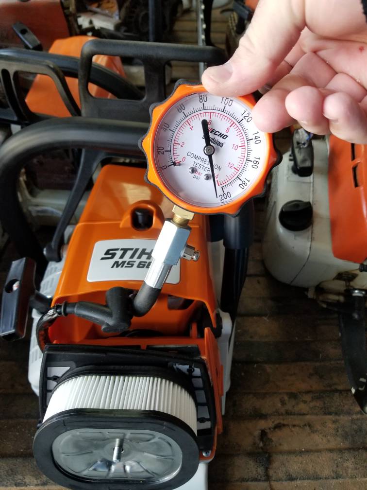

Can you check the compression?

What I get with less than 5 minutes run time, no cuts made.
Maybe it needs thin base gasket.....
Nah.
That's a lot of compression. You installed it w/o a gasket?
So how does it run?
I have been thinking of switching piston manufactures and including the Meteor piston instead of Chinese.

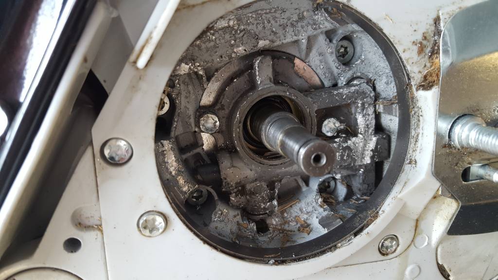

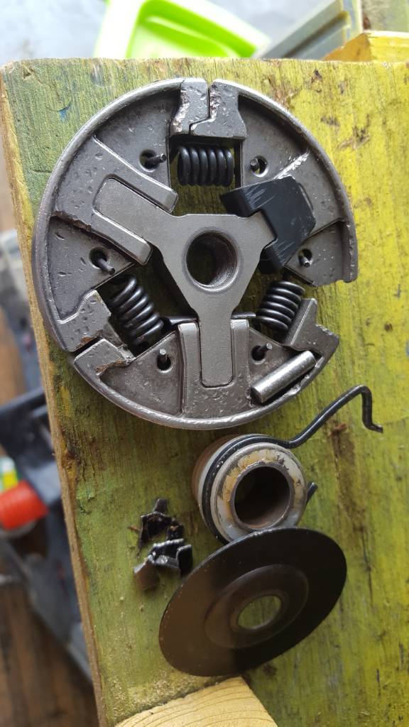

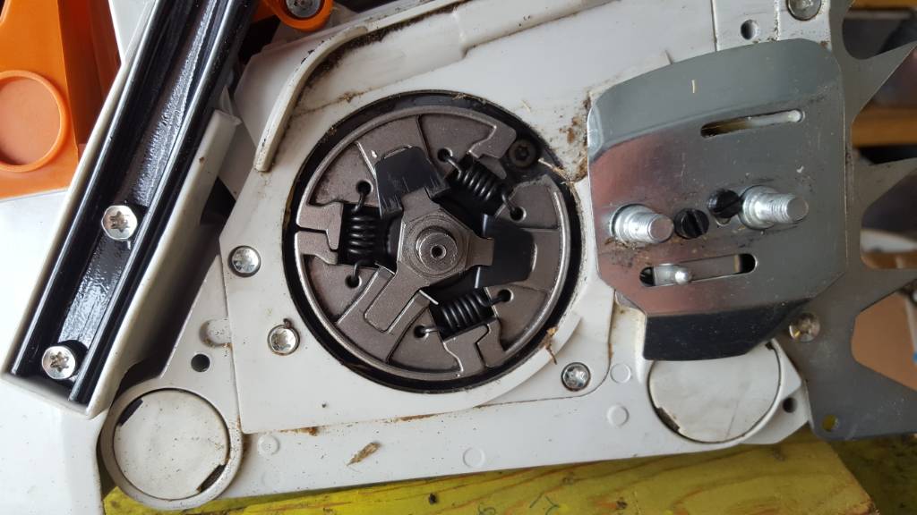

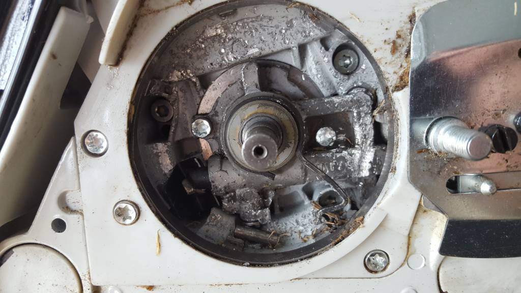

Well I had a bunch of dental work this AM. Took the day off, its 60°, and I wanted to run this pig. We made half a cut...
Case pin backed out after I thought they were set too deep to the flywheel. Clutch, oil pump driver, oil pump and mount bolts are toast. It ran real good first half the cut with 32" wide nose, full comp buried.
Cross jug, meteor piston. No gasket, just 518. Dual outlet muffler. Tuned nice, spooled nice, etc. Had to shave the skirt on meteor for FarmerTec crank, OEM crank cleared nicely. Its a good combo from what I see.
Sent from my SM-G920V using Tapatalk
I noticed when I did mine that the pins seemed to fit a little loose. I used motoseal on both sides of the gasket. Hoping now that it'll help keep those pins in place
To keep this thread clean Ill start another in a little bit. Get some more minds on the site thinking "how to prevent" and make it searchable.

The pins on the early kits were much too loose, I got lucky and my pin fell out when I was hammering the crank to center it.
The two most recent kits I got had pins that were in solid.
Sorry that happened to you, you were not the first, it was in some of the threads, but tough to keep track of all of it.
That fackin sux
Pin too small or hole too big?
