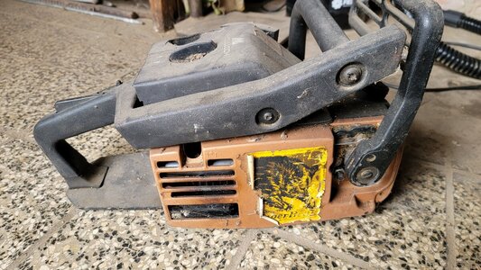

In their day, they did some amazing work for us when we use to go into the woods and prepare our winter stash.
She is now in full retirement in the museum of saws that started it all for me.
Had her up in the attic, never got around to her till this spring.
Did not know how to: tension, sharpen, cut, maintain, dress, start and such.
Small scar on the filter housing, got semi runned over by the tractor. Me feeling a bump while turning, oops too late.
These ones bring back a lot of great memories, even when we did not exactly take care of her that well.
