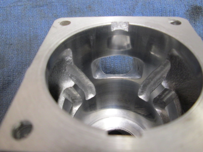

Here is what mine looks like.

That is some damn good looking work. Might not run worth a chit, but it's pretty.
