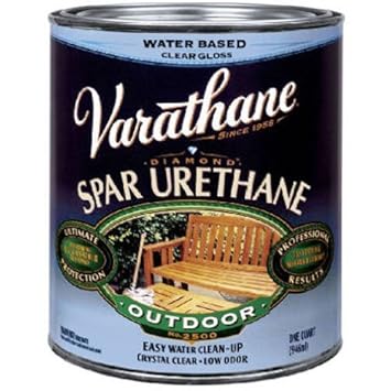

The first thing I want to try building is some benches for around the firepit. I figured this would be a good first time project because if I screw them up. They'll be by the firepit and if I'm there most of the time I have a little jag going on, so I won't notice it anyway......
What are you sealing the wood with once it's dry?

I have had better luck with this water based stuff than oil based ,the oil base has been flaking off on me ,the water base must flex more or something .
Spar is what the carving guys been using for as long as I can remember.
Something about lessening the affects of UV light.
