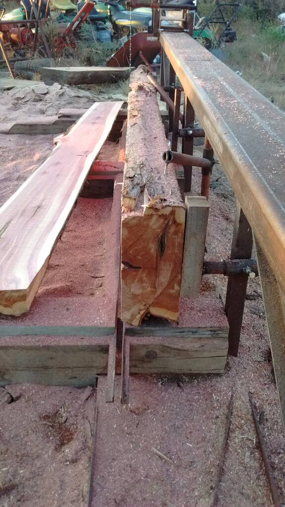

I have a homade Alaskan type with all the adjusters for easy thickness changes. I will put a pic if it up tomorrow can't find one on my phone. But here is my hybrid wood bug type rail Mill that I build from scrap. I run my ported 066 / 36" on for making quick slabs, beams or dimensional......
I always just make my own ripping chain to my own preferred recipe...this Mill is true to 1/16" almost no wander. Makes much straighter cuts than the band Mill we have. I will get some better pics tomorrow.....
