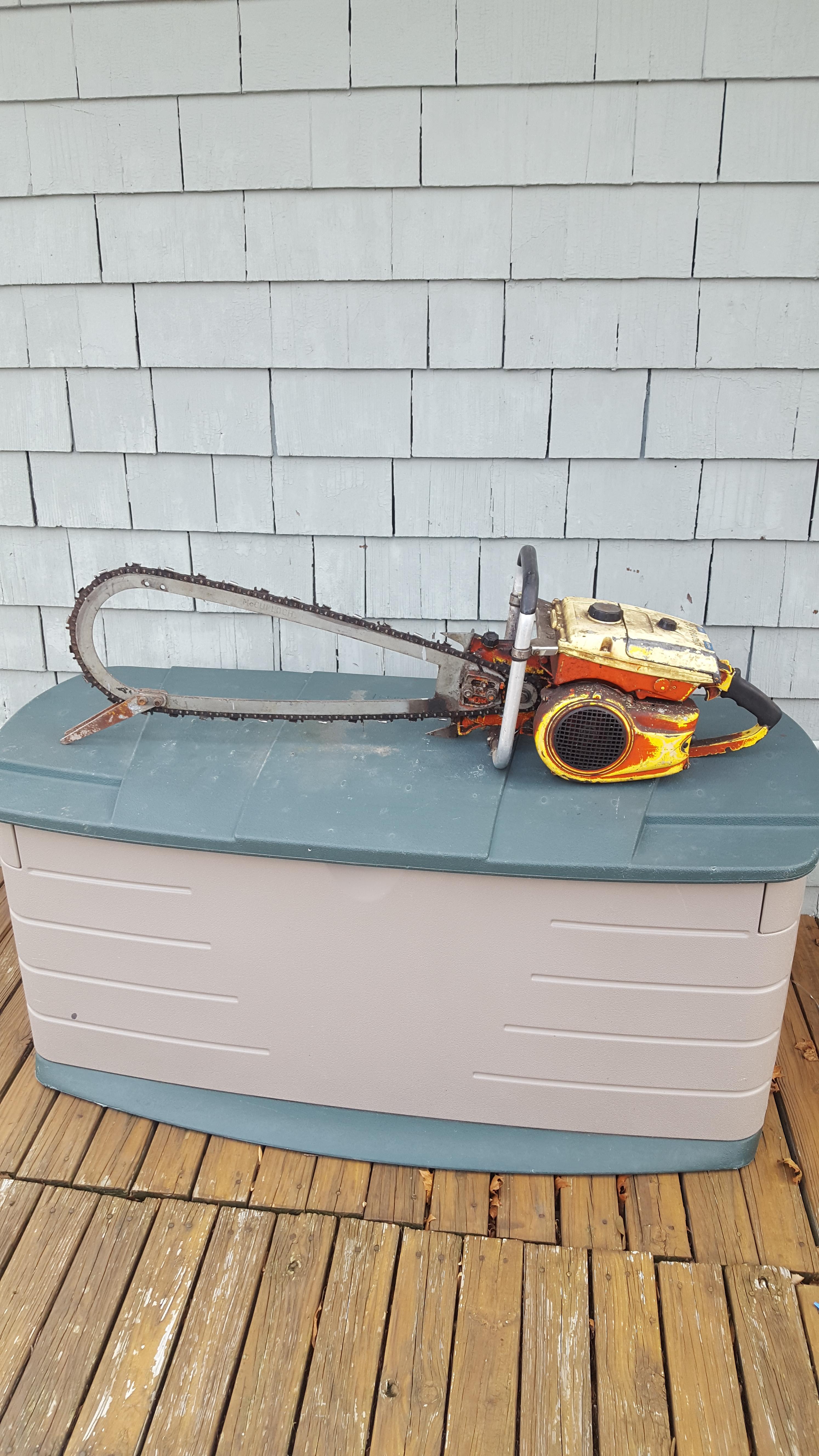

If I'm lucky the chain off this brush bar might work
