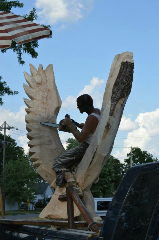

Howdy guys! The setup I prefer these days are my Jonsered 2055 with 3/8Lp mini bar for blocking out and a ms 250 with a dime tip carving bar running 1/4" chain. You can only run 1/4" chain on any dime to carving bar. You can however move up to the quarter or toonie size and run LP 3/8..I have never liked a top handle saw for detail they are just a lot harder to steady in the hand. Not as much control as a rear handle.... Oh and thanks for the kind words but I'm just the vessel the Lord supplies the gifts...
