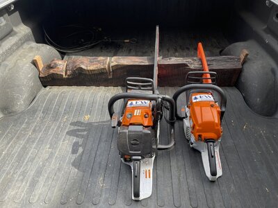

For that price range and bar size, you can't go wrong with Stihl MS 261 CM. It is the smallest "Pro" saw (besides top handles) Stihl makes. It is lightweight for its power, and has a decomp valve, which most don't need but if you have any physical limitations starting a saw, it helps. It will run a 20" bar no problem. You can use Green (anti-kickback/safety-ish) or Yellow (Halloween Horror Movie) type chains on it. I use one day in and day out and it is just a pleasure to cut with. I'm sure Husqvarna has an equivalent but I'm unfamiliar with their model number lineups. I would only go with Stihl or Husky...buy once...cry once...(in reference to spending good money for a quality product that will last)
MS 261-CM on the right. This was the start of my mid-life crisis...still ongoing....
