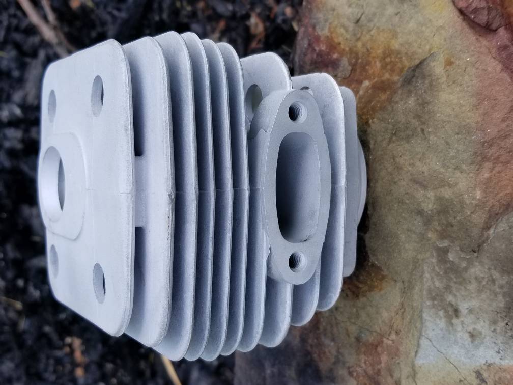

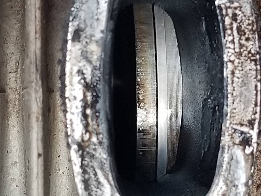

How does everyone remove carbon deposits from piston/cylinder? This is the worst one I’ve ever worked on? Normally it just scrapes off, but this stuff is ON there! I got the loose stuff, but wow this stuff is hard. I am going to have a discussion with the owner about mixing gas and tuning. I think he’s running straight oil!
Are there any solvents that eat carbon but not aluminum?
