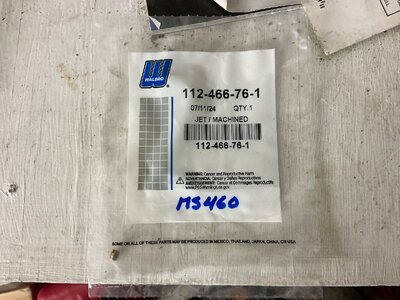

I‘m running a .76 in mine with an open dual port muffler. From what I‘ve learned the .68 was for USA emission regulations. The 046‘s apparently had a larger main jet.IMG_0031.jpeg

I‘m running a .76 in mine with an open dual port muffler. From what I‘ve learned the .68 was for USA emission regulations. The 046‘s apparently had a larger main jet.View attachment 471153
Doesn’t really matter as long as the adjustable jet adds plenty of fuel in addition to the replaceable fixed yet. Only difference between .68 and .76 is about 1/8 of a turn
