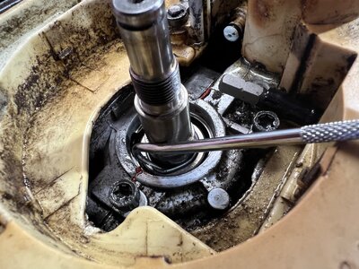

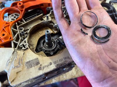

Well lads I had chance to look at her this afternoon.
Monumental air leak in the crank seal on the clutch side, see picture of the remains.
The carb passed pressure and vacuum no problem, I adjusted the metering lever a little and we’ll see how that get on when she’s back together.
@hacskaroly That break cleaner trick is one for the back pocket, thanks for that. 🫡
Air filter, impulse line and flue line are all solid, with the lines being pressure checked too.
The decomp valve was leaky too so I’ll replace that.
I’m hoping that the air leak is the only source of my issues but we’ll see.
It was hilarious finding it, I couldn’t even get the slightest pressure on the hand pump so I turned my compressor down to 7psi and hooked it up, could hear the air flying out :facepalm:
Blatant air leak
Thanks for all the help men, it’s muchly appreciated :thumbup:

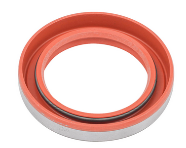

Vintage Engine Repairs
7:50 AM
10195
Aug 15, 2019
504
1,988
australia
Glad you found it. Note that there are 2 types of seals in the IPL, get the ones where you have to take the clamshell apart. The others are notorious for leaking. Replace both sides and note there is a step on the crank on the PTO side, it can catch the lip and prolapse on installation. Stihl sells a tool, or you can use some film, a calking nozzle cut to length, machine your own or tape to soften the step.
