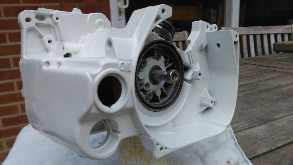

Just a quick one. OEM side casing cover. Nicely refinished courtesy of some nice Ford tractor white...

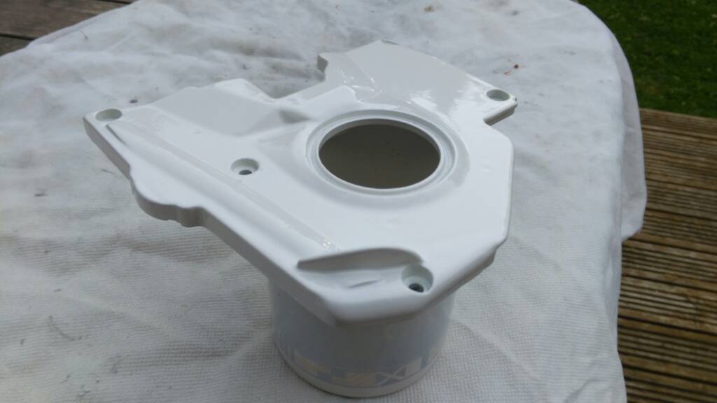

And another, three thick coats. Should be pretty durable when all the solvent has evaporated from the paint. Lighting is pretty crap so the reflections are a bit off. It looks good although there are a few pin holes. In hindsight I should have filled them with stopper, but I tried to drown them instead.

Hey. This is a big place, good to meet you' local-ish guys.
I seem to get lost in these long long threads here and there,,,,,, I must say That Looks super sexy white undies paint, broom or no broom, but I can't wait for the Verrroomm vroomm video
Cheers:aplastao:
