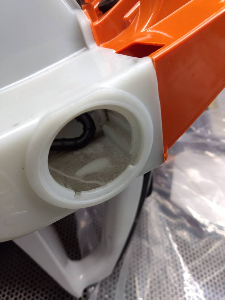

I don't know if you've been reading the 660 rice burner sub thread, but a few ave said there tanks needed a flush. I willsee if I can find the link or pic.
but for what its worth and the time it takes, i,d flush

As for the tank? Make sure it doesn't leak before ya put too many more parts together around it! Been there, done that with an 036 FarmerTec tank. Fixable with Seal-All and still not leaking after several months, but found out the hard way the tank was defective. The outer tank half literally separated from the handle with only a little nudge. Not good. Easiest way to check it is to pump a few pounds of air into it through the fuel line. Should hold several psi unless the tank vent is bad..., which was also the case with this particular tank. (DDave includes an OEM vent with all his aftermarket MS tanks that use the button style vent because they're so problematic.)
