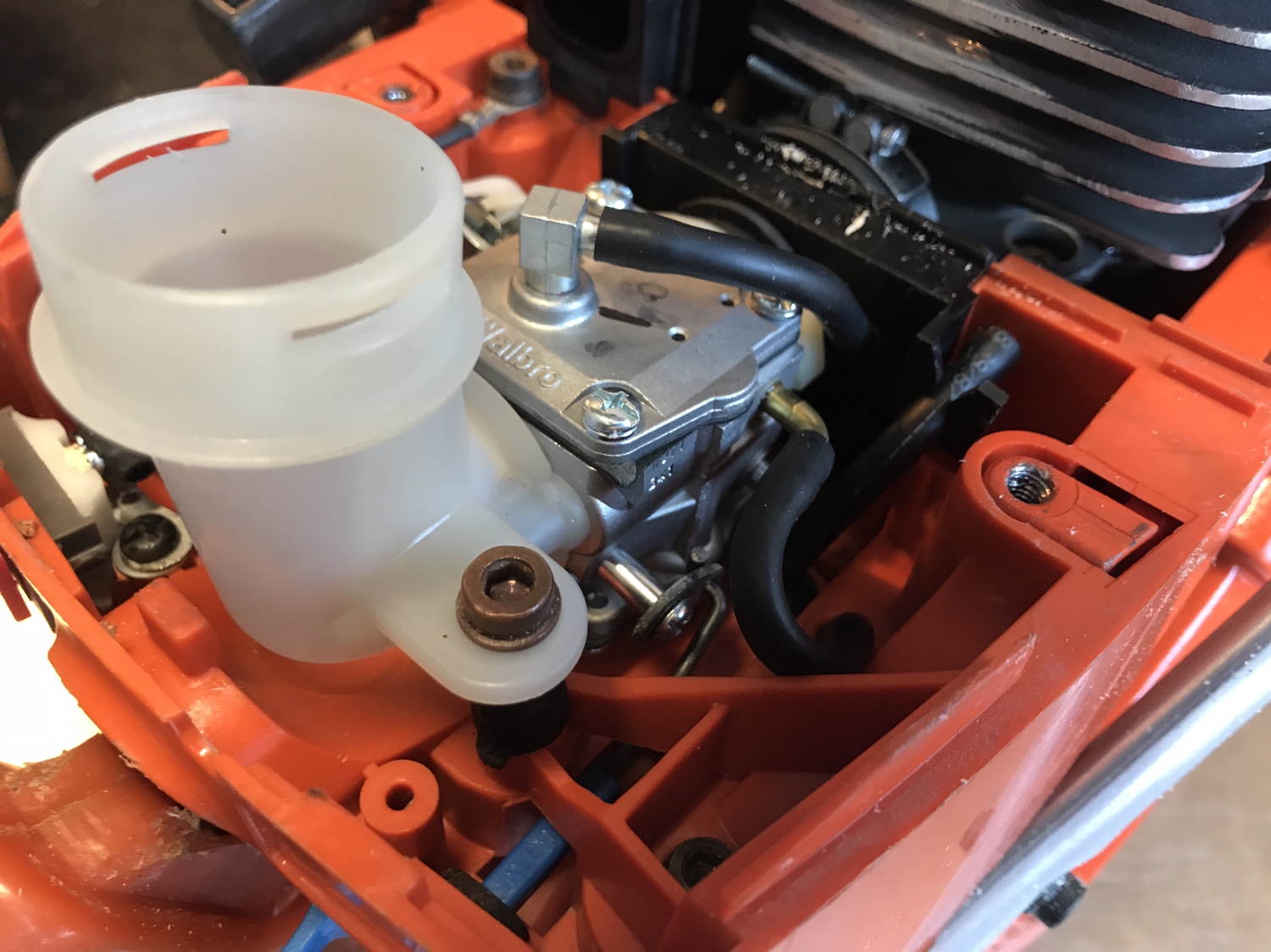

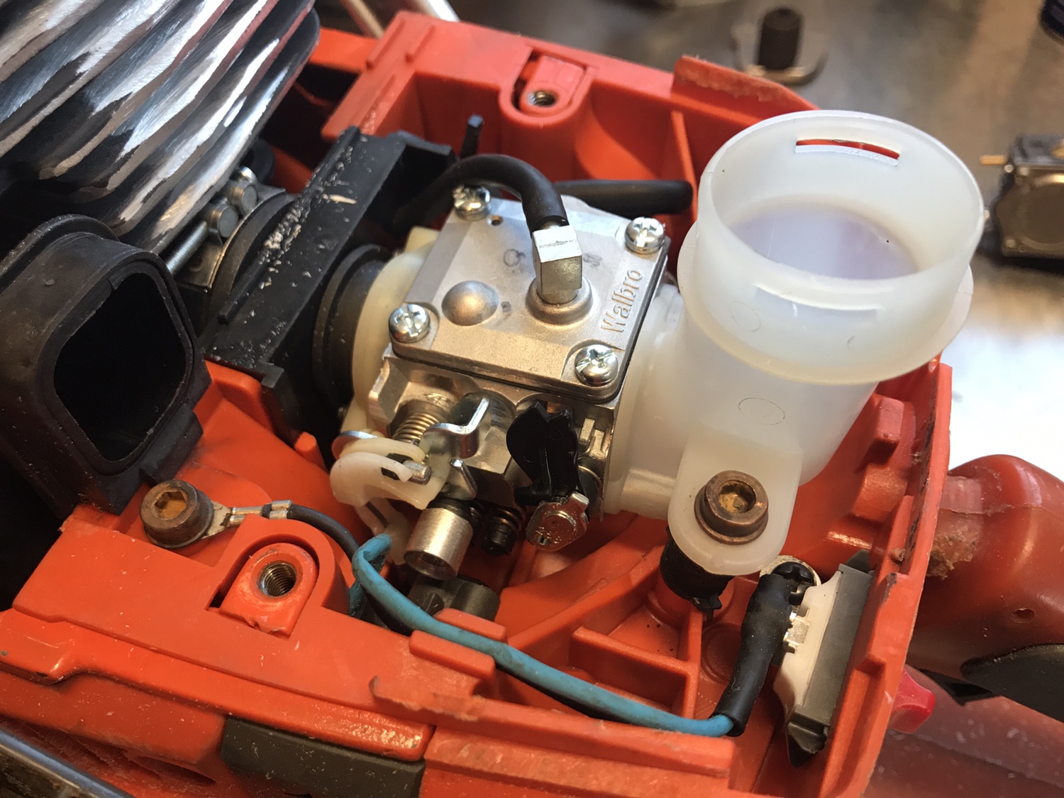

Well, I guess I lied. Adapting a WJ-71 to a 395 isn't as easy as adding an external impulse. Turns out the throttle shaft sticks out father than the stock carb so the throttle cable binds up. So it will take a little more work than I wanted to bite off today.
That’s exactly problem I have too Shaun :(

I have been eying a junk rwj4 I have here and think I can swap the shafts? I don’t know if the carb family is similar or not? But I guess I’ll find out if I attempt it. I even drilled the carb bolt holes larger in the wj71 to accept the 395 carb plastic bushings (7/16 drill bit I think). The reason I even attempted all this was I believe I read somewhere in the husky 394/395 conversion literature that it was possible to use the 394 carb if you put a top impulse on it. Maybe I missed something? I’m sure you’ll think of something easier than swapping throttle shafts Shaun.
The WJ-71 isn't technically a stock 394 carb, maybe the shaft sticks out farther. I don't have a 394 carb around to check.
I finally made the car work, I ended up taking the throttle linkage plate of and cutting the shaft down by .2" and swedging it back on. Then I had to bore into the carb body for room for the return spring and deal with some other minor clearance stuff. Also I had to shorten the idle adjuster screw. Really a pain.
