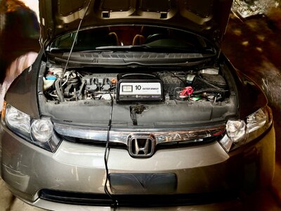

Philbert
I have the same charger pictured here always worked well for me.
