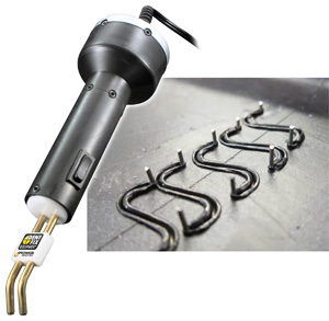

We used to have a gentleman who was our local small engine guy. Long sence retired. One day we came in and smelled something funny. He was using a large soldering iron of sorts and pressing a steel mesh into a Jonsered plastic top that cracked. Somebody here should know if this. What was that iron called? I'm thinking if getting one and trying that out in some broken stuff I have. Links of a YouTube video or a website would be great.

Just called a soldering iron that I can recall.
But for what you are trying to accomplish an old junk screwdriver heated up with a propane torch will work, or even an electric soldering iron.
After that, to really make it a solid repair, put a layer of epoxy over the screen material.
Also if possible, glue or weld the crack prior to this procedure.

I'll have to dig into this when I get home sometime. It had a large roundish end with a flat bottom. I watched him do this to a couple when I was there. Don't recall if I was told a specific name for it or not. But was neat to see for a newbie 17 year old.

They were called , soldering coppers, they came in weights like 1 lb, pound and a half, 2 lb etc.
