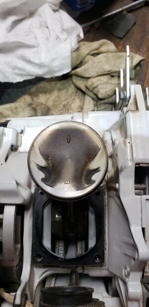

I as well have run it in my saws for years and have never ever had one issue.
I get it from my Stihl dealer and he told me that it was devolved by the US Navy in 1913 and is still the same formula. He told me that it actually runs cooler than regular gas. He also told me that it has an infinite shelf life.
I have NEVER put any kind of Stabil in it and my stuff always starts and the carbs never have had any issues.
The only additive that I mix in with the gas is Marvel Mystery Oil along with my 2 strike oil if I am mixing it for ny saws.
I did a complete rebuild on an 066 that I had. Ran it for quite a while and was curious as to what everything looked like after a lot of run time and this is what it looked like.

A stihl dealer sells aviation fuel?

100LL was not developed for the Navy in 1913...
It does store for a long time, although not infinitely.
It also exposes you to the inhalation of lead and bromine compounds. Yea, no thanks, not in handheld equipment.
