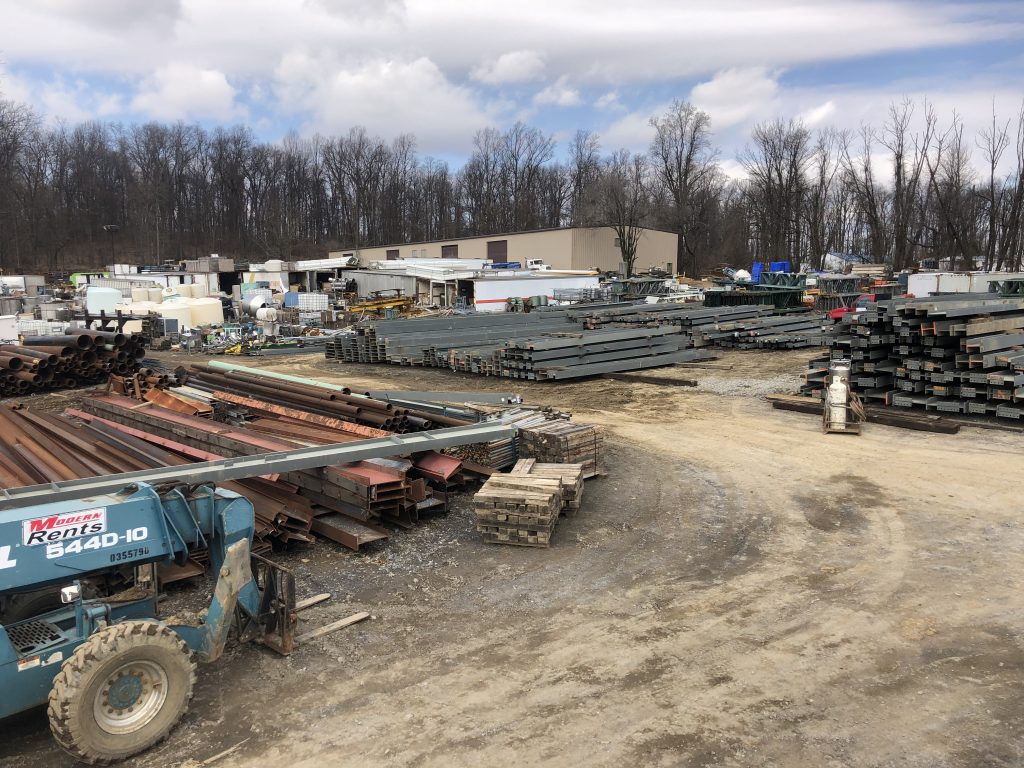

I have a few home made aluminums but I only use them for gapping out 2 plastic wedges on the final push to get the tree over. Im not a fan of cutting close to them after literally snapping a tooth off my old 55 rancher.
The best wedges i have are the ones I made out of blocks of UHMWPE from the local junk/scrap yard.....God Bless Glick's and their fabricators wonder land of stuff, its mind boggling.

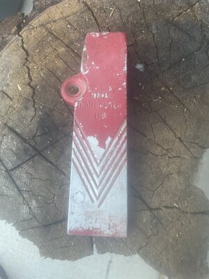

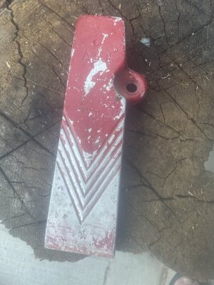

Just to keep the thread alive. I picked up this little beauty at an estate sale the other day. It will go in my wedge pouch to try out. It might be handy to stack on top of a plastic wedge when things get a little tense. Or should I say “in a pinch”. IMG_7878.jpegIMG_7877.jpeg

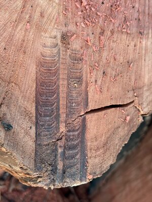

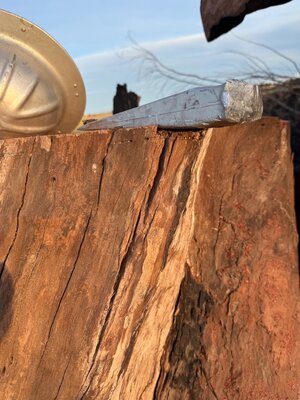

I realized a lot of My trouble with wedges popping out was geometry and species. With a small diameter tree, the distance from the back of the tree to the hinge is short, so the angle is much steeper, short wedges make it worse for the same reason.
Also the trees being desert species are hard and springy, a whack pushes the tree fwd, releases pressure on the wedge, and then it springs back and squirts the wedge out.
