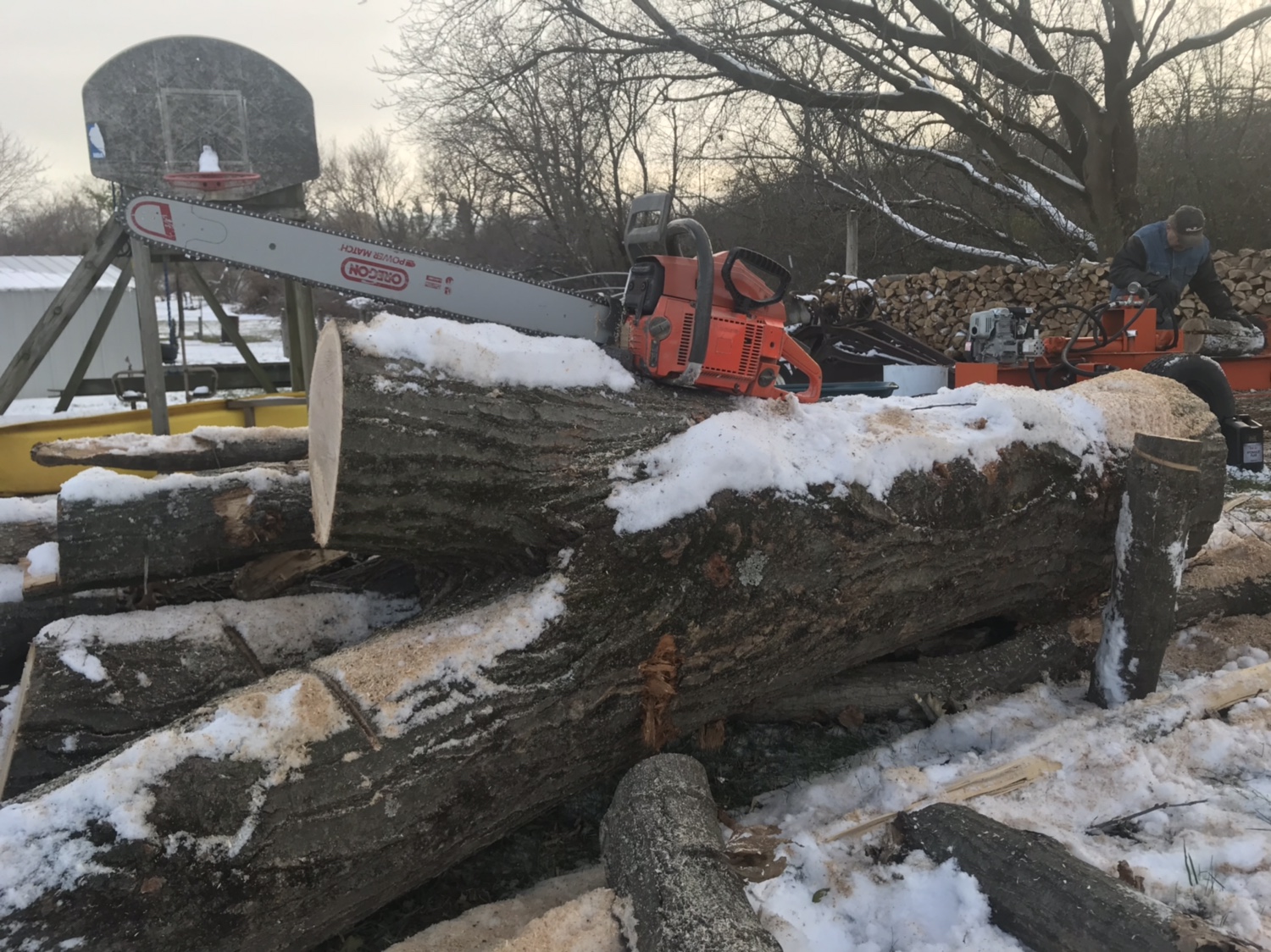

On another note, got it running with a modified Stihl Mount Oregon bar but will only fit 7pin rim until I spin up a longer chain.
I found the same when mounting a 84dl (25”) Stihl bar on mine. Had to make it 85dl.
I run 99 links on a Stihl mount 30" bar designed for 98. I only avoided going to 100 by grinding the hell out of it. If you grind the slot a bit, you can fit the 25" Stihl bars with an 84DL chain.
