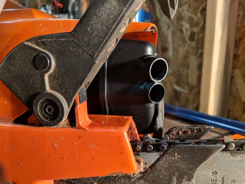

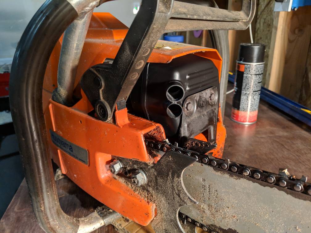

Finally got my Chinese muffler after waiting a month. Found a piece of pipe roughly the same diameter as the one on the muffler (.600") and used my Dremel to open up the case. I've never brazed anything in my life but my mig welder is out of commission so that's what I had at my disposal. It's not super pretty but there are no holes in it so I'm fine with it. Couple coats of stove bright and back on she went. The bolt holes on the muffler were perfect sized which was something I've read is not always the case. I'll test and tune it tomorrow.
Sent from my Pixel 2 using Tapatalk
