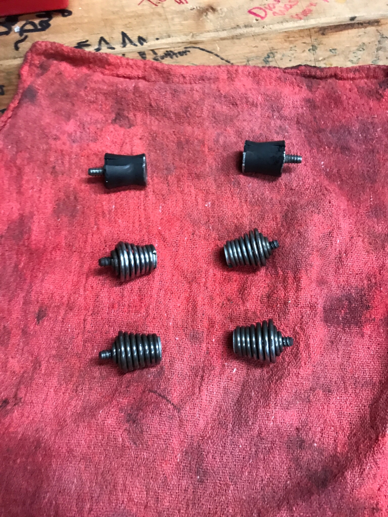

They don't make springs for the front tanks mounts. The 4 rear are the same spring mounts as the 262.

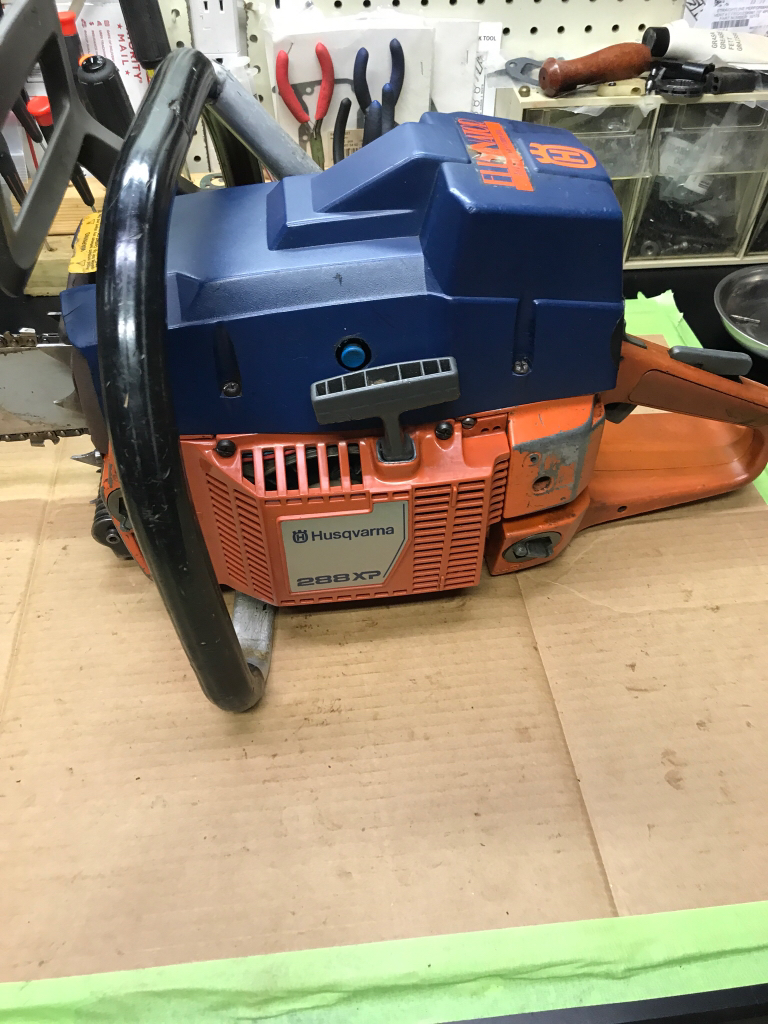

Thank you sir...that answered my last question. I’m going to experiment.. I have 6 rubber mounts in here now:
Then I’ll swap to these:
And see which I prefer. I’ll share what I think, not that my opinion is very important [emoji23]

No one has done this, your opinion is very important. I was talking with Joe and I was pondering if springs up top and rubber everywhere else might be a good combo. Maybe just another configuration to try if you don’t like 4 springs.

A great friend of mine says springs rule..some of you guys say rubber is the way to go. All I know is I have a decent size downed sweetgum in walking distance from the house..and a great reason to use the 288..it’s for science after all.

This is the preferred method (4rear springs, 2 front hard rubber) of the ‘spring’ people I’ve heard from.

Actually I ordered some mounts from my local guy this morning. Gonna try two rubbers up front and 4 springs in the back along with the spring on the front of the case. If I don't like it I'll change things up till I find what I like. I figure it can't hurt to experiment little...for science! :)
