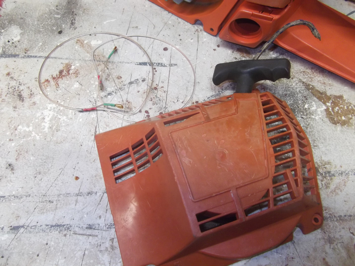

More on this project - I got Dave's recoil fitted up - It's faded but solid and the weathering matches the airbox.
I'll polish them up later with a little 30-weight non-detergent motor oil. I got a couple of kill switch wires made up too.
