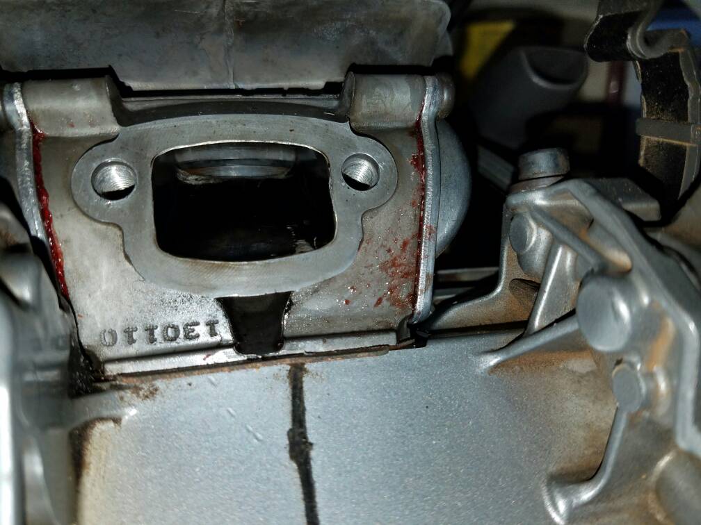

So i tried rtv red with the gasket first that was a mistake it blew out, then i went with anaerobic without the gasket it blew. Now im thinkin just JB Weld the sob and be done with it. Any other suggestions?

Let it sit for 2 days[emoji31]

I use Loctite 518, but I don't recommend it to others. Everything has to be extremely clean, and there is a cure time. The Yamabond, Hondabond, etc is easier to use.

Yeah that was stupid of me not to put the gasket back in I didn't realize the gap was as big as it was on that side. I'll try and find some yamabond 4 on the way home from work today, if not I guess I'll try the anaerobic permatex again with the gasket.

Loctite 518 anaerobic sealer for me too. Clean all surfaces including o'rings really well with solvent then alcohol and it works good.
Do what Alan said here.......clean......clean......then clean it again.

Thanks for the help guys I appreciate it. On a side note, I learned what a bad air leak sounds like on a saw lol!

It may be simple to just goop it up and screw it in, but make a project out of it, like others have said, clean real good and take your time with what ever sealant your gonna use. I use a nail to spread it and make sure I do a neat job along with proper coverage.
