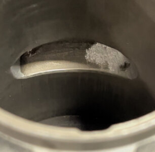

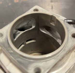

I'd throw a piston in that jug and run it for R&D. It might eat rings a little faster and be slightly low on compression but you'll still get to make some adjustments and know exactly where you want the new one to be. It will only cost you a piston, meteor is good option or you can go with the cheaper Hyway from CCC, but you may want to grab caber rings for it.
I agree completely.
