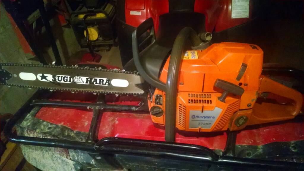

image.jpeg image.jpeg Excuse the rough shape of this saw but it's a sleeper ;) it's got a 52mm bb I messed with and runs a 8 pin 20 or 24. This saw is a 2000 and I believe 99 was last year of the 371 and this saw has the see through fuel tank that the 371s used as well.

:)View attachment 58445 That ain't stock :)View attachment 58446 second starter it's broken, compressions good I'd say :)
Nice! and there's those big fins like 371. Part of the motivation to change was chips getting in there and strength of the fins too I've heard.
I don't think you had that one at Dan's that day. But I think I may have ran that one if you had it the last CT GTG. If you had it there I know I at least watched you run it before or after you ran my 262.
Bring it to the NY GTG or CT GTG I'd like to take it for a spin! Should kick my 372 X-torq model being mine is stock. At some point I'll at least open up the muffler on my saw.... although they sound really nice stock -- nice bark at idle.

There's actually a couple more besides the decal cutouts. The starter housing has the additional ribs that were introduced around 02-03. I think Huskyboy's starter pic shows the earlier housing. And, the 2 top cover decals should be all yellow.
