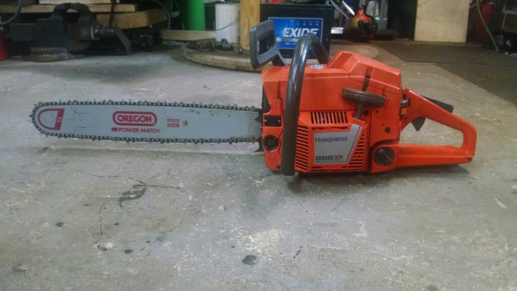

My 262 has a Sugar Creek decal on the starter cover. Very happy with it. It is the 262xp professional one which earlier 262s had a lot of times the KS 87 variety.
Sent from my XT1585 using Tapatalk
I'll nit-pick yours now, get a new fuel cap!
Otherwise, good looking saw! Never run a 262xp but they sure have a following.
He makes a nice decal for sure
I have the original cap and replica replacement but both leak bad. The newer cap seals. Tank has a crack so I plan to replace it. Hopefully then I can go back to the original cap :)

So do mine; just the gas one. The oil ones never seem to leak. I wonder if the oring from a new one will work? Can't see why not.

o-ring part #503 26 30 17 from 371 ipl. The new style cap seals are shape differently.

Thanks Wolverine.
And I just grabbed a new style gas cap. Next time I need o-rings for another project, I'll see if I can find a match for the older style caps.
Thanks for that part number as well cable guy, Appreciate it
