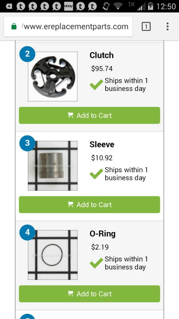

Also, why does the IPL give me two different part numbers for the same crank sleeve?
503 77 91-01
503 96 70-01
Or, if there is a difference, what are they? I cannot tell....
503 77 91-01
503 96 70-01
Probably just a superceded part number.

91-01 is the sleeve.
