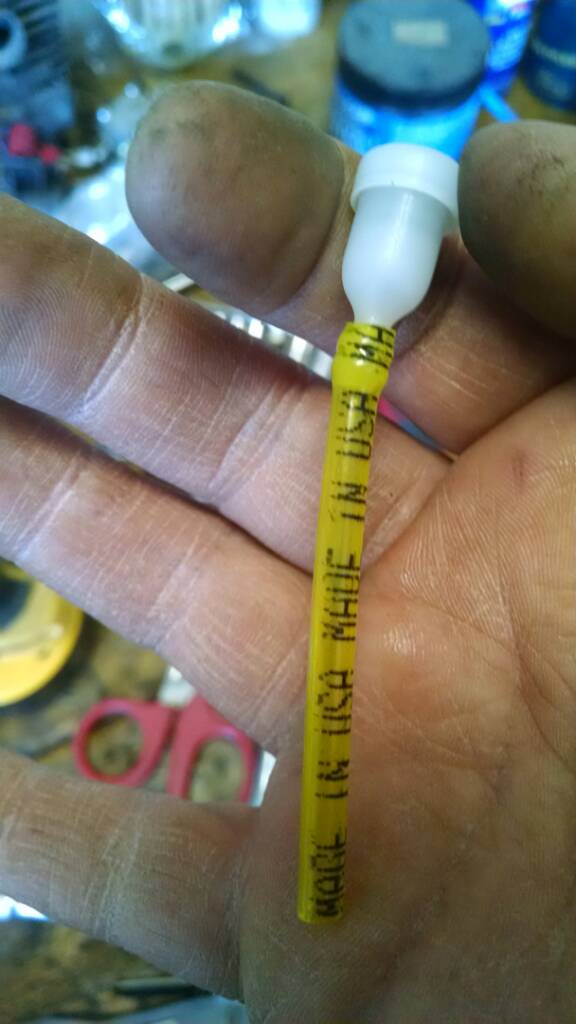

Pulled this one back off shelf this week-end to start over. Awhile back I ordered a new intake boot, and carb base. I'm waiting on a gasket at the dealer to pick up before I get it back together. I did find this though. I know more this weekend
