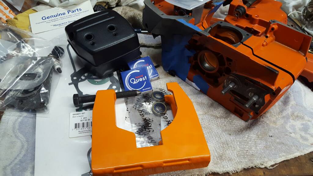

My next issue lies in the bottom end. These bearings are shot ! Chunky is the word that comes to mind, they haven't come apart yet but are in bad shape.

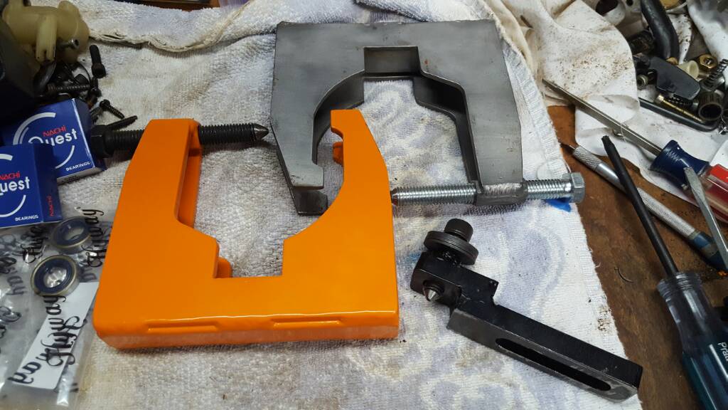

What is everybody's recommendation on splitting cases ? I have seen some homemade splitters that mount to the bar studs. I've seen a couple C clamps zip tied together. Then there is the tool made for the job that costs about $80.
Is the $80 tool really worth it for a hobby guy like myself ?
To each his own. Mine laid around for a year(I bought it on sale) before I used it. Sure worked slick. If there's a pattern cutter handy they're pretty easy to build.

I could build the bar mount style pretty easy. It's seems that style is putting a lot of stress on the studs in a direction they weren't designed to.

I made one. I'll have to take pics of it later today. Used it on the bar studs.
I'm in the same boat on this, although I have been more willing of late to buy specialty tools when needed. I'll probably end up buying a case splitter.

I used the orange one on my 272. Many ways to get the case apart though. Heat does wonders!
