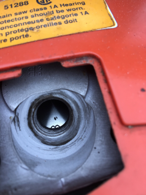

Ok I warmed her up and tried tuning her but she would idle ok then just die. In the cut sounded like too much advance, popping.
So I set the timing back to almost stock. Nada, somethings not right...

Pulled the plug... Uh oh!!!

It cleared ok cold but not warmed up.
Question is can I add a copper washer to the plug, or do I need to pop her open and grind a little out of the piston?
And what is the proper clearance to the electrode?

First I thought it was the hda87 i send to you, was one of the first rebuild I did....
I wouldnt grind the piston, there has to be other ways to fix the issue, you are probleby not the first one who goes through this
