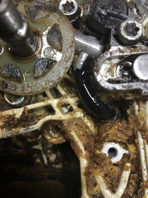

A friend of mine who is a tree guy gave 2 saws he wanted more out of. 200t exhaust side is scored, so I'll be tearing it down.
This 201t piston and cylinder look good through the plug hole and exhaust port.
Saw is really dirty, but the case looks like she's getting excessively hot. Is this because of the choked up muffler and she just needs to breathe? Can't cool cuz it's dirty? Dull ass chain? Combination?

Has the spark arrestor been removed in that 201?

It appears to be mia.
That's why the plastics by the sprocket are all black and burned. I see it quite often on 201's. Tree guys think they can pull them like on the 200's and it does the same thing...all it really does is help direct exhaust forward like that and burn the plastics. I'll bet the clutch cover looks all black and burned too. That appears to be a very well maintained saw otherwise. :eek:

I agree, the 201's roast if you just pull the screen. I usually drill a 3/8 hole in the side of the muffler and trim a little plastic from the clutch cover.
Done a couple crank seals on 200's and tons of intake boots, fuel and impulse lines . Looks like they need a good steam cleanin

I just finished cleaning a friends 200t. It was all gunked up too. The oil cap was leaky and the flywheel was drawing it in and coating everything with it is what I am thinking.
