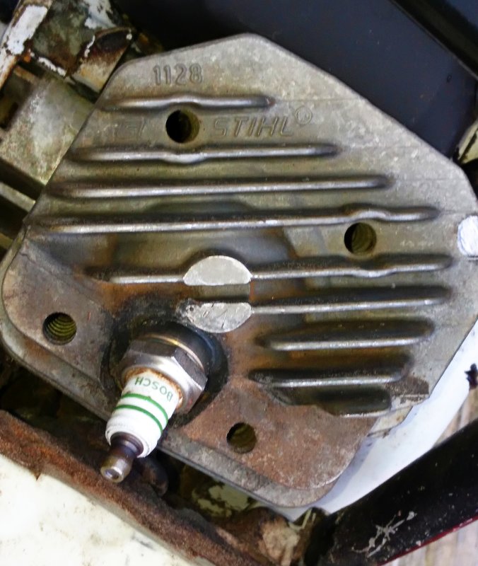

Jason, since it is a Red Lever 044 I would love to know the SN, the jug details (ie KS w 3 +), and what you think of the factory porting & timing. Thanks.
I think there was a "sweet spot" for 044s, and that saw likely is in it. Saw a couple of strong stock 044s at GTG, one a Red Lever 10, and one a Red Lever 12. The Red Lever 044s are the later 10 mm and early 12 mm saws.
Here's sumfin for ya, Mike:
Looks like maybe a later Mahle cylinder? Saw has a serial in the 128 range.

Look on the sides of the base, I'll bet it is a KS. How does she run??? Has the winter filter option. Those old tank vents can cause problems.

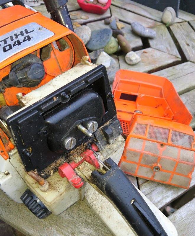

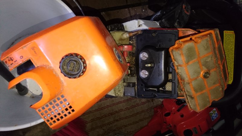

It runs very strong. Has a DP muffler on it. The filter is the standard non HD euro filter. I can't really see the writing on the sides of it. I'll check it when I pull out the flywheel and advance the timing some:

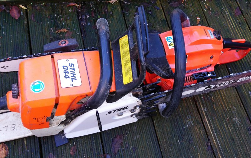

Customs never remove my brake decal:
